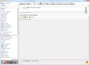

One thing is that in HLHQ when choosing Commodore Amiga on the left, Emulators, it only says WinUAE in the emulator list, not WinUAE [Global]
It seems to me something is missing in the module?
7z is disabled and as HLHQ finds the "roms" I hope the path is set ok.
7z is disabled and as the emulator starts I hope the path is set ok.
With Commodore Amiga selected on the left. And Emulators selected on top. What is listed next to Default Emulator? This is where it should be set. If you have anything in the list below, delete them. It should look like this:

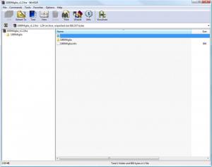

Now, open up one of your game roms. It should look like this:
[ATTACH=CONFIG]43606[/ATTACH]
[ATTACH=CONFIG]43607[/ATTACH]

That´s how it looks for me too.
What happens if I try to open a game with HLHQ is this:
Do I have to change something else in WinUAE, add a HD file or something?
Maybe I haven´t copied all files fron an archive into WinUAE?

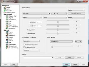

I´m still having a little trouble with this.

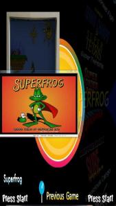

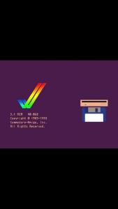

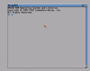

If I start a game from Hyperspin the game loads and starts, but none of my settings are loaded.
I have a vertical widescreen and the fullscreen resolution is 1080x1920, if I choose filter and set Set aspect ratio to auto in WinUAE it looks as it should.
The second picture is if I load the configuration manually in WinUAE and the last is if I load a game from Hyperspin.
It seems that amigahost.uae isn´t loaded, what am I doing wrong?
[ATTACH=CONFIG]44363[/ATTACH] [ATTACH=CONFIG]44362[/ATTACH] [ATTACH=CONFIG]44364[/ATTACH]

It´s in the \Host\ directory, but what is it that points to the amigahost.uae?
The full path is D:\Hyperspin original\Emulators\WinUAE\Configurations\Host\ is that ok?
Where, were, ware - it´s not my thing, don´t remember when to use which
The HyperLaunch module looks to that directory for the amigahost.uae file.
I´m really sorry, it´s my head that is a mess right now.
It´s no good idea trying to solve things in haste because it´s late.
WinUAE Loader has nothing to do with this problem I think, otherwise the games wouldn´t have started att all I guess.
This is what the log file lokes like:
