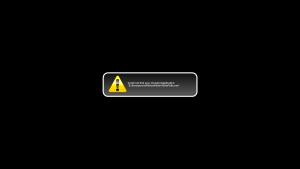

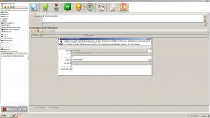

nath2099 Posted July 28, 2016 Author Posted July 28, 2016 So trying to get the Playstation Emulator working. I have placed the emulator in E:\Emulators\ePSXe200 but for some reason RL is looking for the emulator at the location in the attached image... "Current emulator list for the selected system" is set to the correct location, and module is set to eSPXe. Can someone explain to me what the module does?
Guest Posted July 28, 2016 Posted July 28, 2016 On 7/28/2016 at 10:18 AM, nath2099 said: So trying to get the Playstation Emulator working. I have placed the emulator in E:\Emulators\ePSXe200 but for some reason RL is looking for the emulator at the location in the attached image... "Current emulator list for the selected system" is set to the correct location, and module is set to eSPXe. Can someone explain to me what the module does? You need to set the location of the emulator in the emulators tab of RLUI. It can live wherever you like
nath2099 Posted July 29, 2016 Author Posted July 29, 2016 Bump! Does anyone have any idea what I've done wrong here?
JayC Posted July 29, 2016 Posted July 29, 2016 Try setting the exact path to the emulator...not the one with two dots but use e:\ instead? Or ask at rocket launcher forums. Not at my computer right now so I can't check it myself.
nath2099 Posted July 31, 2016 Author Posted July 31, 2016 Starting to work this out, turns out I had to update the module to point to the right executable.
