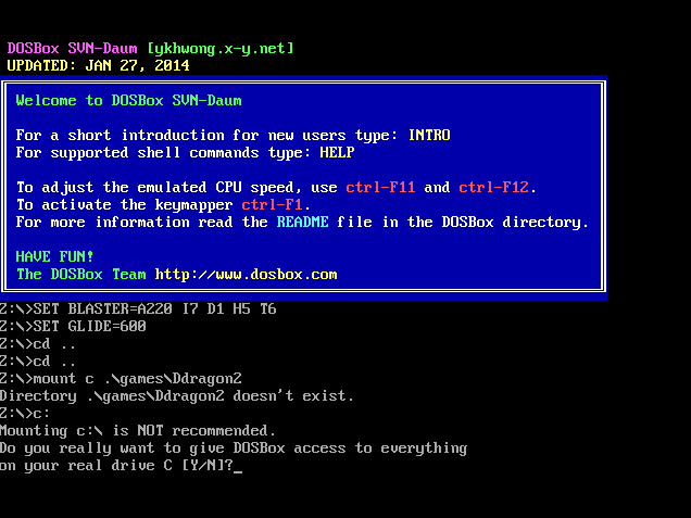

gamesmame Posted August 25, 2016 Posted August 25, 2016 Please help here.. Why this happening!? :questionmark: :questionmark: IF i type Y or N anyway independet how i type, this screen disapear and back to menu =(
dougan78 Posted August 25, 2016 Posted August 25, 2016 It cant mount .\games\ddragon2 in dosbox. Does it do that for all games? If so probably zipped and 7z needs to be enabled in rl. If you have it extracted, as in the whole set then path may be wrong to roms in rl. Otherwise if just that game it might just be an issue with that one and I have run into that when setting up my lanparty rig and I needed to edit files manually to mount right.

gamesmame Posted August 26, 2016 Author Posted August 26, 2016 ExtractPath is wrong. Read module notes. Please, How i fix it?
zerojay Posted August 26, 2016 Posted August 26, 2016 Is there a reason you are ignoring what you've been told both here and the Rocket Launcher forums? I've told you what the issue is. Read the module notes, your answers are there. Sent from my SM-N930W8 using Tapatalk
Guest Posted August 26, 2016 Posted August 26, 2016 Yep, @zerojay is spot on here - and I'm sure I mentioned this in the RL forums. The DosBox module for RL has been made to work with the eXoDOS set, and the module notes are very comprehensive. Read through the module notes, following all the steps, and I'm more than sure that you will find it working.
