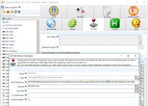

Yes, just checked. I also ran the rom manager to match all the file names as well.
Also, within rocketlauncher when I audit them I have a match where it says the file is found.
I stand corrected, mame no longer works as well.
Like agent47 suggested you need to have the file extension in your list of extensions to the emulator your using in rocketlauncher.
Open your rom folder and check what extension is on the end. If it's zipped open the zip file and look. Then go to rocketlauncher Global->emulator tab->then the emulator your using-> add the file extension to the list of extensions. If the file is zipped enbale 7z unless its mame leave it false.
Thank you - the mame solution worked perfectly... but still having an issue with genesis, super nintendo, and nintendo.
I checked the file extension on the genesis and they were GEN files. I checked the extensions allowed and found this, which includes gen:
7z|zip|sg|sc|gg|sms|gen|32x|md|cue|bin
So that doesn't seem to be it. I really appreciate the help and efforts. Is there any further information in any specific fields I can provide?
Does the file name of the gen file inside the zip/7z match the database name in RLUI?
Yes. I had an old hyperspin set up in the past that worked and loaded these up correctly; that computer since crashed but I had backups of all the rom files that I'm trying to run now.
7z is enabled, you can tell that by the original error message.

I should also say that I ran this via the Rocketlauncher UI. "Launch the selected game through Rocketlauncher (Alt+L)".
Are you sure that the rom inside the Gain Ground (World).zip is named Gain Ground (World)? Can you post a screenshot? I know I keep asking but if the rom inside has a valid extension the only thing that makes sense is that the rom inside is named incorrectly as the error indicates. I was able to replicate your log when I misnamed the rom file inside my archive.
Assuming that the rom inside has a valid extension you could set "Match Extension" to true on the bottom of the Settings -> Main Settings tab and that should work.
Don't feel bad that you keep asking. You're trying to help and I appreciate any guesses even if it's confirming that something isn't right on my end. I stand corrected, it is named something different within the zip file. That's odd, as the previous time I set up hyperspin using these rom/zip files (probably about 4 years ago) it all worked fine with the same zip files and gen files contained within.
But, your "match extension" to true worked. It fixed the issue completely. Thank you VERY much!!
