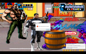

bionicrocky Posted September 16, 2016 Posted September 16, 2016 DISREGARD - FIXED, don't see how to delete a post here. It was Hyperbrite. Had I searched directly here instead of just Google I'd have found it right away. My fault. Hello, I am getting the error "usb error please check sign is connected" every time HyperSpin starts, once I click OK it shows up again any time I make a wheel choice. What have I done? I don't /recall/ making any changes. My log from my Hyperspin directory is pretty empty: 02:50:12 PM | HyperSpin Started 02:50:12 PM | Going FullScreen 02:50:12 PM | Checking for updates 02:50:12 PM | Update Check Complete 02:50:12 PM | Startup program unavailable 02:50:12 PM | Error intializing joysticks 02:50:12 PM | Menu Mode is multi 02:50:12 PM | Loading Main Menu.xml 02:50:12 PM | Main Menu.xml successfully loaded 02:50:13 PM | Main Menu wheel loaded successfully 02:50:19 PM | Loading MAME.xml 02:50:19 PM | roms_only is true, checking files 02:50:21 PM | Main Menu.xml successfully loaded 02:50:22 PM | MAME wheel loaded successfully 02:50:26 PM | Loading Main Menu.xml 02:50:26 PM | Main Menu.xml successfully loaded 02:50:27 PM | Main Menu wheel loaded successfully 02:50:34 PM | Exit program unavailable 02:50:34 PM | Quiting Hyperspin 02:50:34 PM | Bye! I'm using a Tankstick using keyboard emulation and have no marquee sign or anything like that. Any ideas?
bionicrocky Posted September 16, 2016 Author Posted September 16, 2016 Yes, sorry, Windows error window with an OK click box. When clicked the window goes away until the next screen is loaded.

DavidSnay Posted September 20, 2018 Posted September 20, 2018 I am having this same problem. I see the above post about Hyperbrite, but I don't know what to do with it. Thanks for any help. Latest log: 10:14:52 PM | HyperSpin Started 10:14:52 PM | Going FullScreen 10:14:52 PM | Checking for updates 10:14:52 PM | Update Check Complete 10:14:53 PM | Startup program unavailable 10:14:53 PM | Error intializing joysticks 10:14:53 PM | Menu Mode is multi 10:14:53 PM | Loading Main Menu.xml 10:14:53 PM | Main Menu.xml successfully loaded 10:14:55 PM | Main Menu wheel loaded successfully 10:16:00 PM | Exit program unavailable 10:16:01 PM | Quiting Hyperspin 10:16:01 PM | Bye! UPDATE: OK, I searched on here and found the answer myself; Run Hyperbrite and turn it off by unchecking the on/off choice. Working fine now.
Bogamix Posted March 23, 2019 Posted March 23, 2019 por curiosidad modifique los valores en el hyperbrite y comenzó a darme el molesto error de USB en hyperspin, lo solucione abriendo el hyperbrite y seleccionar la casilla de los valores predeterminados (restore defaults).
