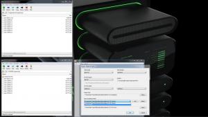

zero dreams Posted March 2, 2014 Posted March 2, 2014 I just use MAME and Demul the same in regards to using the set that respects the emulator. I just opened a rom that was identical in size between the two sets but they contained different files inside the zips. Also, I've never had Sega Naomi fully up and running till yesterday but I'm using Demul 0.5.8.2. Using two directories, I store my bios in the roms folder with the emulator and the other directory I have set for Naomi roms as I haven't set it for the other systems it can handle yet. Hopefully this pic will explain what I'm trying to say. HyperLaunch | HyperWiki | HyperSearch | Intro | Evolution | FadeProject | Checker | Steam Wheel
