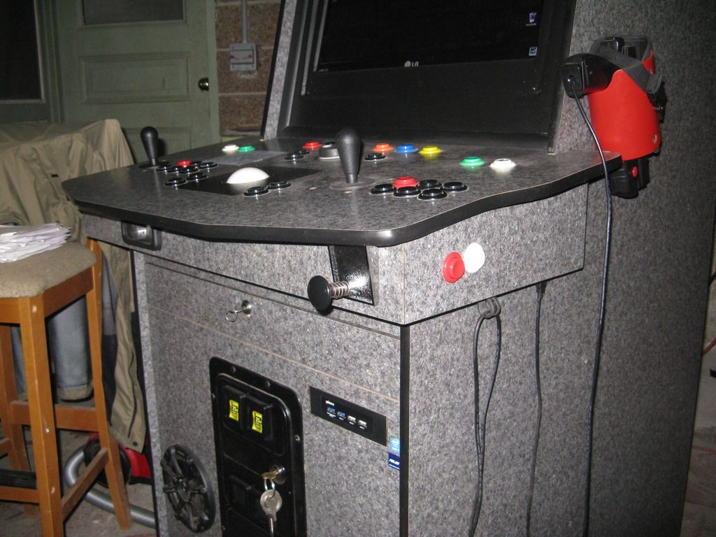

I thought I'd post a few updates I've been doing to the arcade cab.
Here's a quick video, if you're bored:  (give it a few minutes for the quality to improve)
Will add a few more pics here as I get a chance.
New Motherboard ASUS H97M-E Intel i7 Quad core @ 4Ghz,  8 Gb Ram (DDR 3?)(2x4Gb sticks).
Onboard sound.  Added a 400W Yamaha Stereo Amplifier(really liking the sounds).  I'll post a short video, but it doesn't do it justice.
Added, finally a LED, HDMI 16:9  25"--26" Monitor(can't recall exact size and I believe are different sizing than crts?)
New Nvidia Geforce GTX 750 Ti  (Does pretty good...play Skyrim maxed out).
Built a custom steel plate (like where Happs trackball mounts to) for my 4-way joystick, so it's higher above the CP.
A Red dragon, micro switch &  illuminated keyboard.

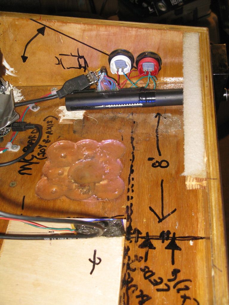

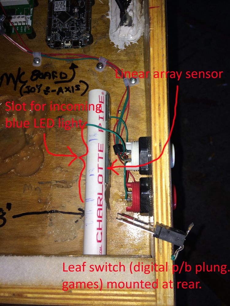

Added a pinball plunger along with the Linear array sensor to make it a mechanical, analogish closer to real thing plunger :)
Works great but still need to set up the 'Zed' Push button option for tables that are pushbutton ball launchers.
*Just wanted to add here that the Charlotte PVC pipe (1/2") fits perfect over the inside flange of the plunger.  Easy to work with and to mount the sensor(s), etc...

Redid my Aimtrak holster, made of PVC, with a nylon gun holster insert.  Also has a nylon locking strap with quick release clip.
Got a good head start on my custom racing pedals.  All aluminum, had my friend weld them for me.  Have to add Magnet/Hall Effect sensor for the throttle pedal & Pressure sensor w/rubber bushings for brake.
