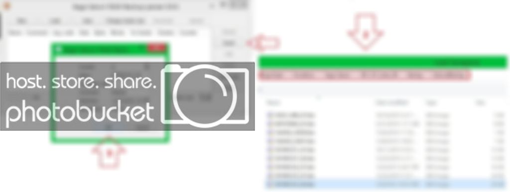

Once you download and open the EXE:
1 - Click in Insert, 2 - Select your SSF save file, my saves were stored in the External Backup Folder because in game I usually chose the cartridge, but I also have duplicate saves under InternalBackup, so the process to convert Internal saves is the same as External, 3 - Press OK

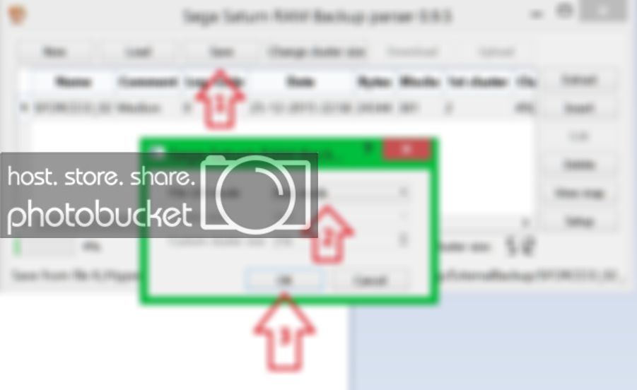

Now Click in Save, Choose RAW and OK:
Choose where will your RAW save be stored, in my case, I have Retroarch to save files and sort them in folders, so it creates a folder named according to the core, wherever are your Saturn saves being stored, save there, in this case, BCR extension means I'm saving an external backup save, BKR means internal save, so when saving, don't forget to copy the cue name and putting BCR or BKR as its extension, so retroarch will load the file as External or Internal accordingly.
