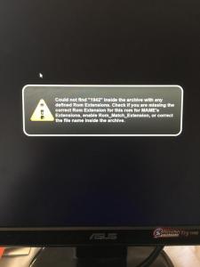

Mame Rom Issue
dziactorx
Is Hyperlaunch or Rocketlauncher still running in the sys tray?
Did that, I dont get the error but the games dont load. Weird, they did before.
So what does happen nothing? Is Hyperlaunch\Rocketlauncher running g in the sys tray?
It will go to the window to play, but the game never plays. Just sits there with a black screen.

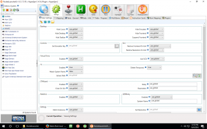

Any sound? You could try temporally turning off bezels or under the Desktop options try changing the setting for "Hide Emulator".
