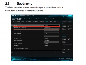

Guest Posted October 14, 2016 Posted October 14, 2016 Ok, so the option you want is show on page 2-13 of the manual linked to above. I've outlined it for you in the screenshot below:
BBBrennaNNN Posted October 14, 2016 Author Posted October 14, 2016 It's currently under normal boot and the only other option I am given is fast boot.. there is no auto boot or anything along those lines
BBBrennaNNN Posted October 14, 2016 Author Posted October 14, 2016 Or maybe I got your intentions wrong. The screenshot is the same as what I'm looking at but I do not see a option to automatically turn on CPU when power is on without pressing physical start button

Guest Posted October 14, 2016 Posted October 14, 2016 Or maybe I got your intentions wrong. The screenshot is the same as what I'm looking at but I do not see a option to automatically turn on CPU when power is on without pressing physical start buttonSo you don't see the option I've highlighted in the red box? Because that is the option that does what you want. Actually, I see what you mean. That option is worded very badly. Let me check the manual again. Sent from my iPhone using Tapatalk
Guest Posted October 14, 2016 Posted October 14, 2016 Unfortunately the manual for this board isn't very descriptive. It should be there. The only thing I can advice is to select 'Advanced' on the top bar, and work down through each settings category. You're looking for a setting like 'Turn on after power loss'.

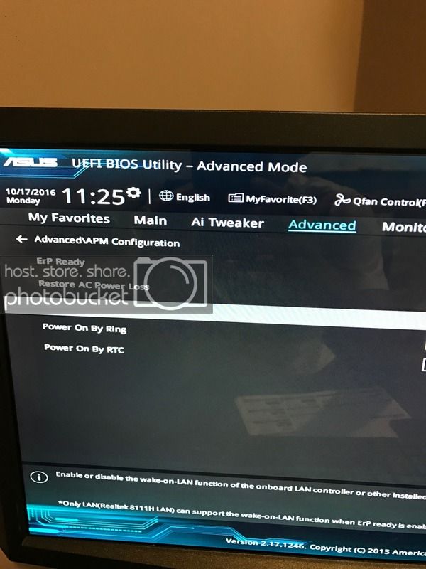

BBBrennaNNN Posted October 17, 2016 Author Posted October 17, 2016 found this option. above the grey highlighted bar. i guess it should be this?
BBBrennaNNN Posted October 17, 2016 Author Posted October 17, 2016 solved~~ thanks all! its under "advanced > apm configuration > restore ac power loss
