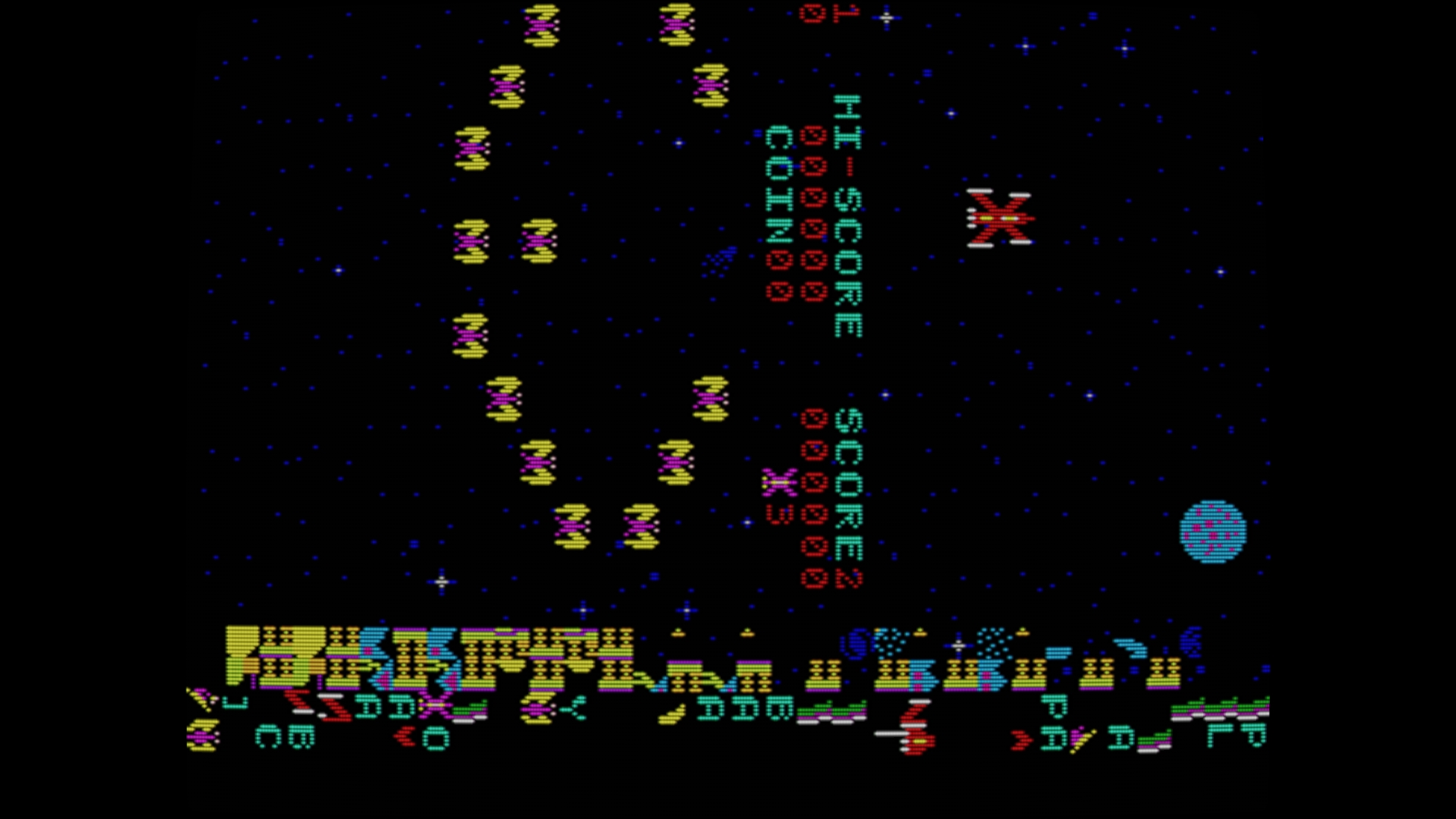

gigapig Posted December 5, 2016 Posted December 5, 2016 Has anyone seen the garbage on the game Phoenix before (see screenshot.) This only seems to happen when I set the game to cocktail in the dip switch setting and does it on all the clones as well. Thanks
gigapig Posted December 8, 2016 Author Posted December 8, 2016 Is able to test this for me ? Go into the dip switch settings for Phoenix and change Upright to Cocktail, then run a 2 player game so the screen flips after player 1. Thanks
gigapig Posted December 8, 2016 Author Posted December 8, 2016 Brilliant Agent so I'm guessing the Rom, driver or mame is at fault?
gigapig Posted December 12, 2016 Author Posted December 12, 2016 Looks like we got this fixed. http://mametesters.org/view.php?id=6452 Quote Tafoid This is a long standing regression from February of 2014 when cocktail mode was generalized for all drivers. Sadly, this is the first report of it but it shouldn't be too difficult to fix. I've set up a bug at MameTesters at this location: http://mametesters.org/view.php?id=6452Thanks for your report.
