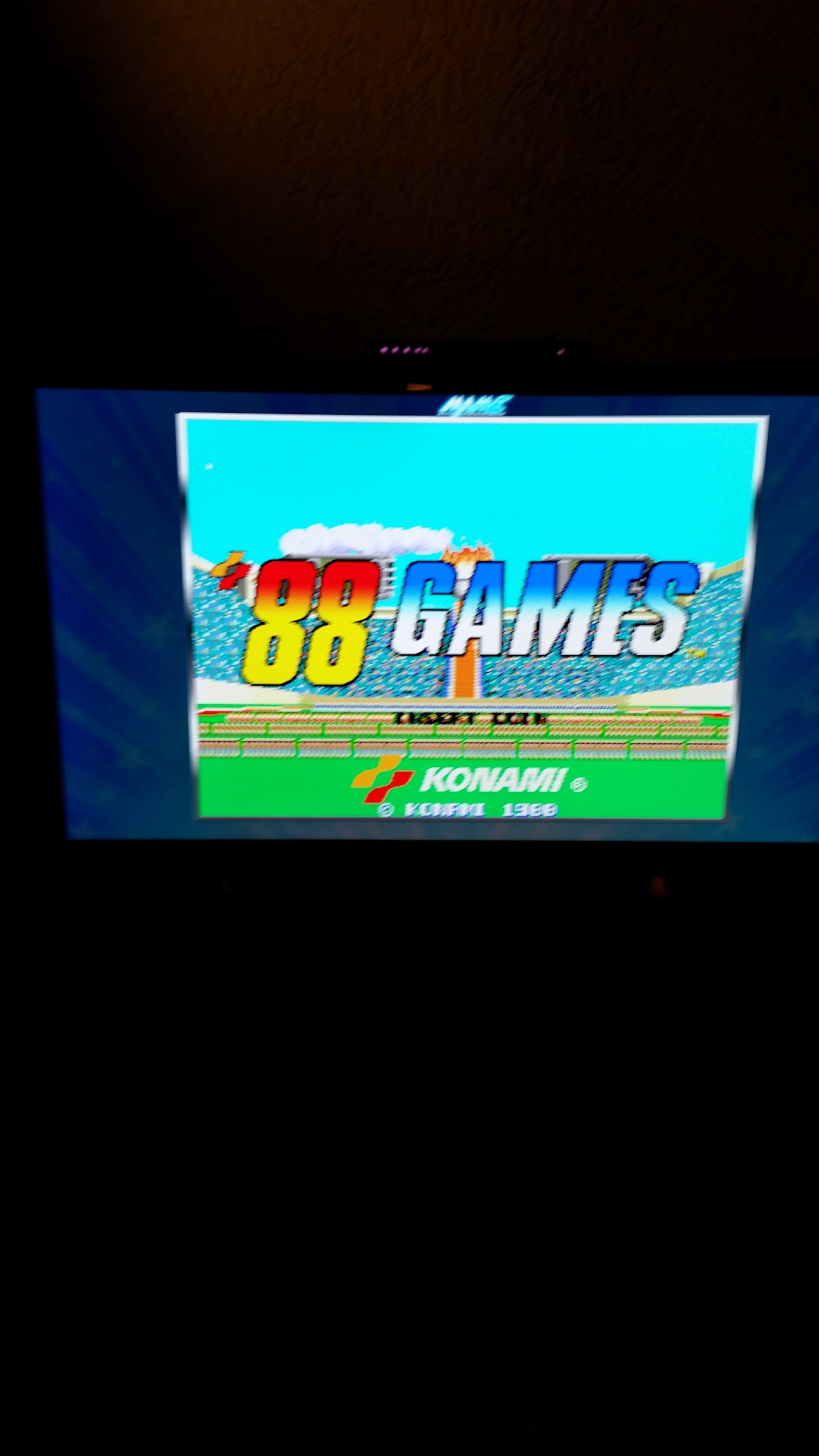

AgelessEddy Posted December 15, 2016 Posted December 15, 2016 Hee people, I've got this weird problem, in rocketlauncher my MAME bezels are all good, but when i start MAME in hyperspin, the games are then not correctly placed inside the bezels, when i edit the .ini files to get the game to go to the correct place nothing changes, is this a setting that i missed or something? Any help welcome grtz Eddy Picture in Rocketlauncher: Picture in Hyperspin:

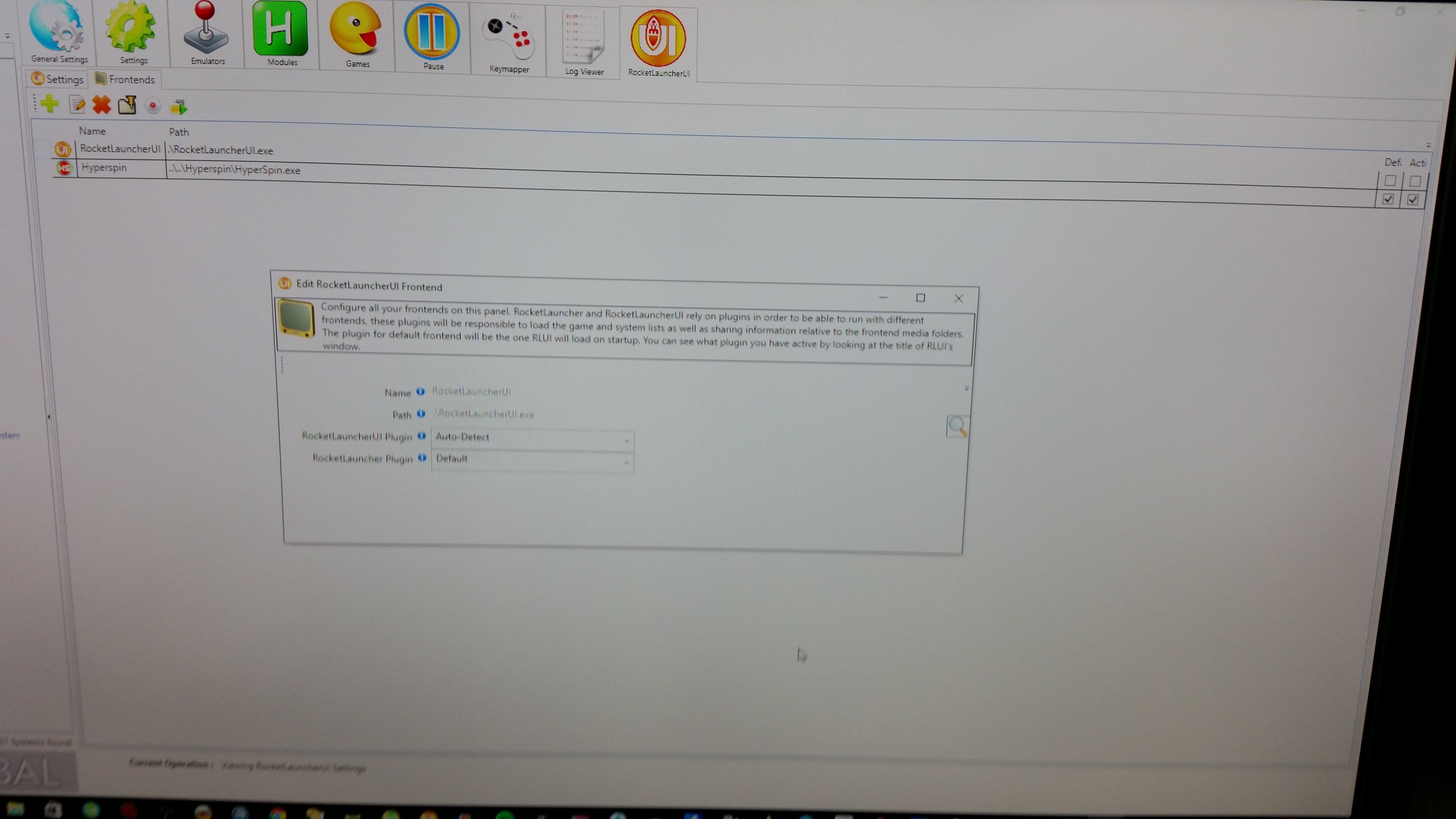

gigapig Posted December 15, 2016 Posted December 15, 2016 According to your log it looks like you have RocketlauncherUI set as the Frontend not Hyperspin

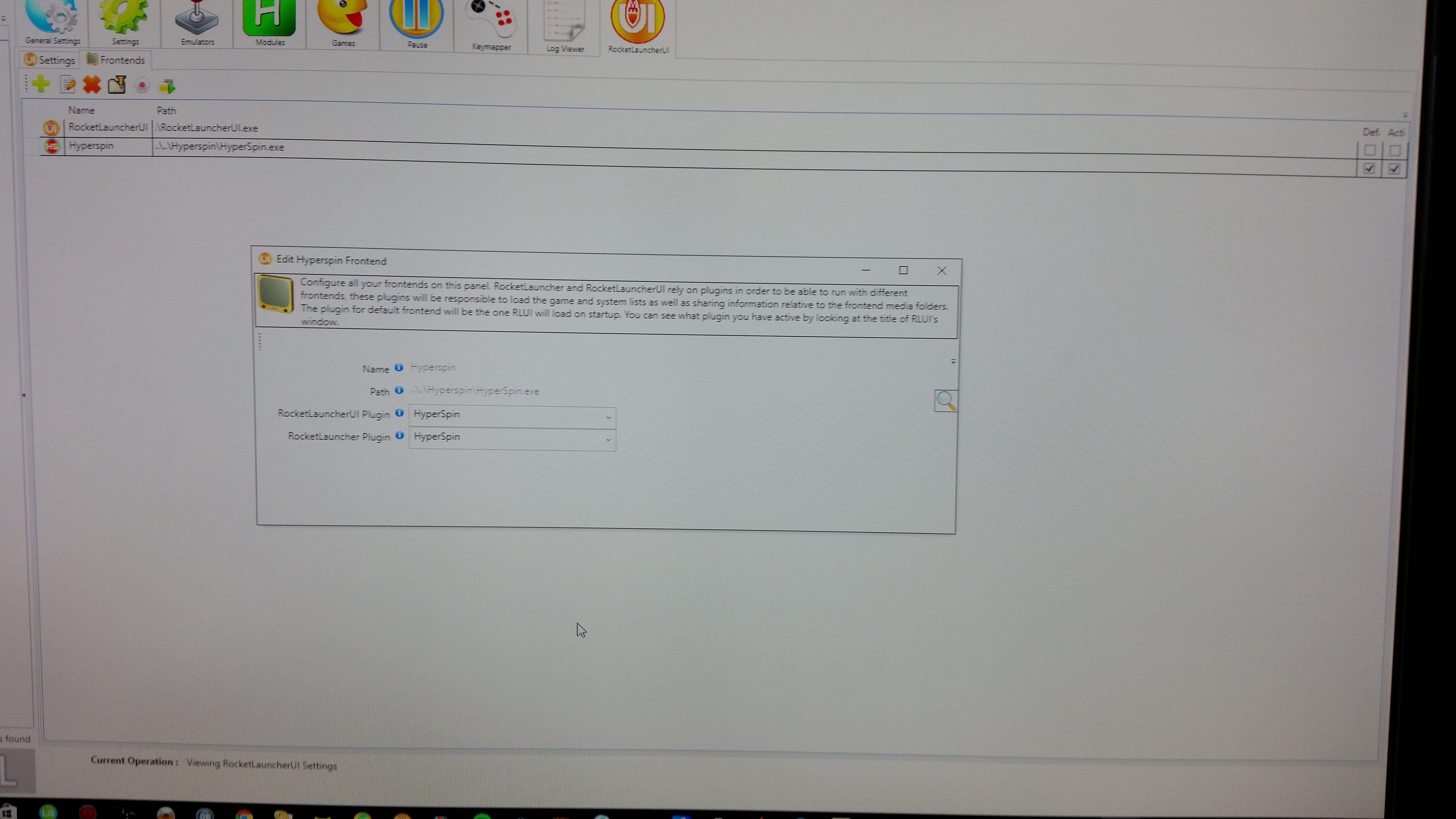

AgelessEddy Posted December 16, 2016 Author Posted December 16, 2016 This is how my frontend settings are Gigapig, does seem right?
