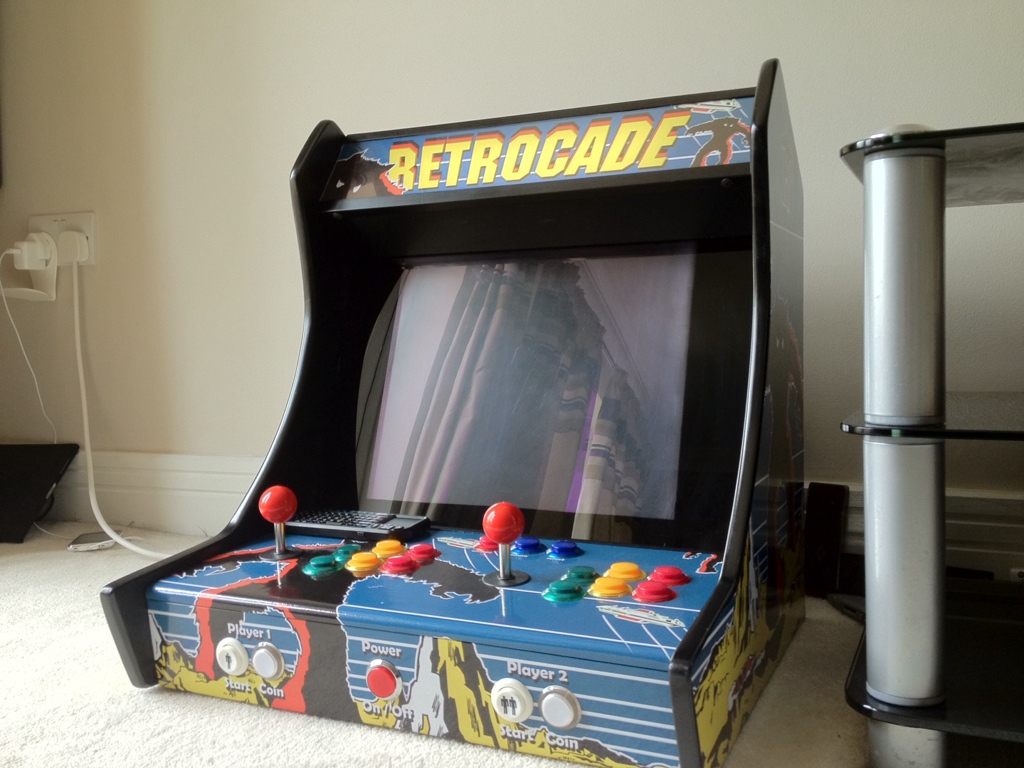

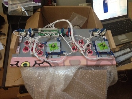

monkeychunkuk Posted April 4, 2014 Posted April 4, 2014 So the only thing I still have maters is how to lock the control panel in place on Bartops The original Retrocade had a gap in base so you could get a screwdriver in but I didn't like that On the Princess Cade I screwed it from the bottom into side rails on the Control panel ...not pretty So how does everyone else do it? I don't want to leave a gap and I don't want to drill through the artwork
