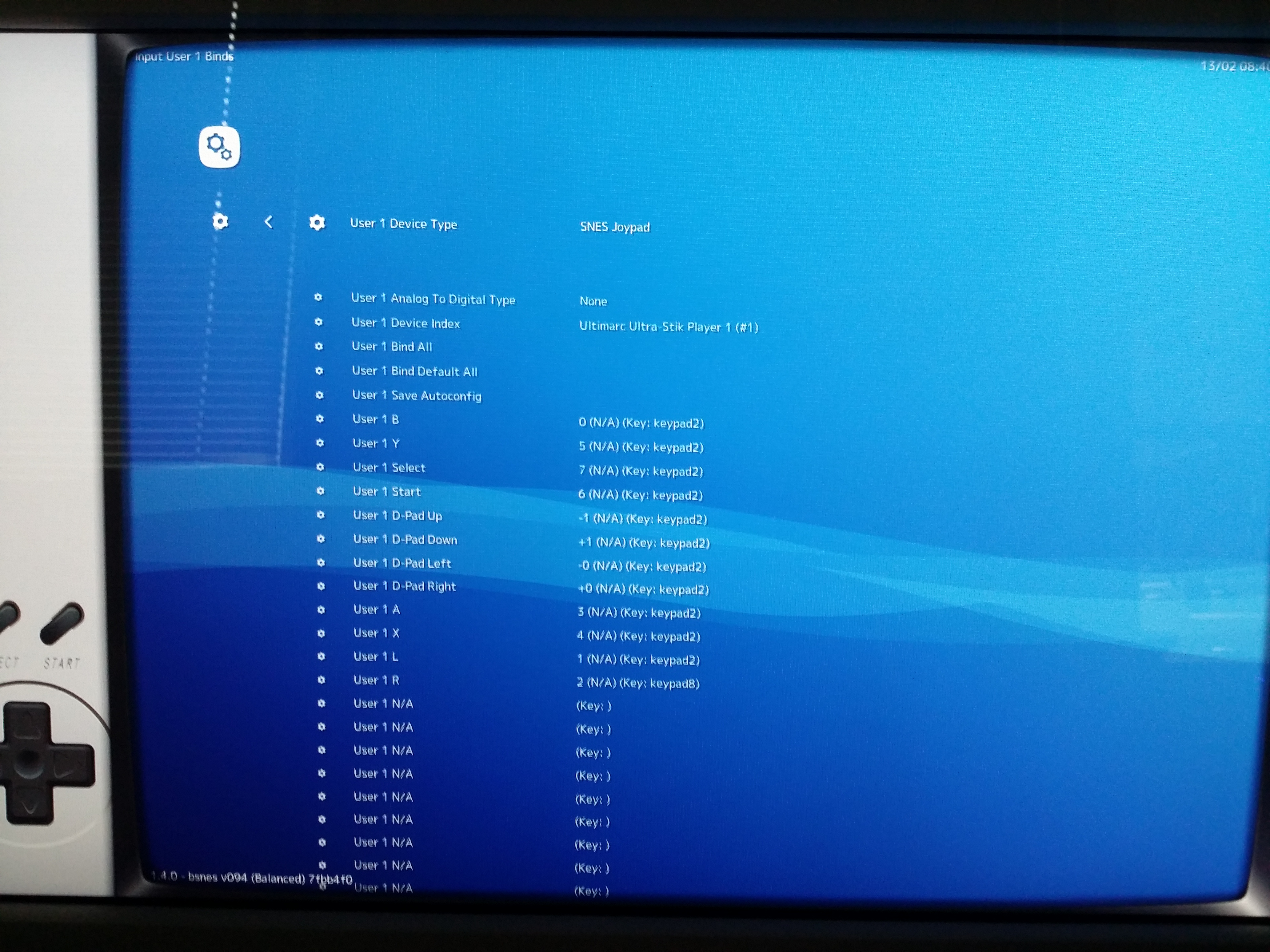

gigapig Posted February 13, 2017 Posted February 13, 2017 I would ask your "Friend" to update your RetroArch to 1.4.1 as that interface is very old now, but it does have the same options. I have a feeling you need to change the "RetroPad" setting to something else (Retro keyboard) under device type, but if "none" is all there is I guess it's correct. Also did your friend set a config per system? Some people here with ipacs have edited the configs manually, could you copy and paste from your working config? Have a look here also. Here's the new interface with my Ultrastik settings.

gigapig Posted February 21, 2017 Posted February 21, 2017 6 hours ago, Becksbolero2 said: Thanks for the reply. Under "device type" the only options are SNES Joypad, SNES Mouse and none. Mom not sure if he set up the config per system or not. How would I find out? also, where do I find the working config? I'll copy and paste it if you can direct me there. Thanks again man. SNES Joypad would be correct as that is what the core will use. Configs are in the config folder and if you have them they should be named the same as the system you are running so in this case Super Nintendo Entertainment System.

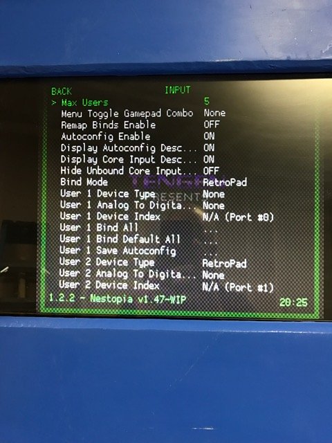

gigapig Posted February 21, 2017 Posted February 21, 2017 You may want to try setting the Bind Mode to RetroKeyboard.

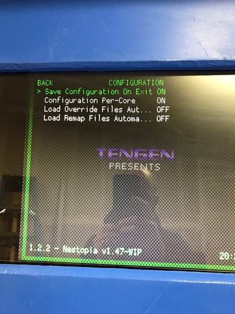

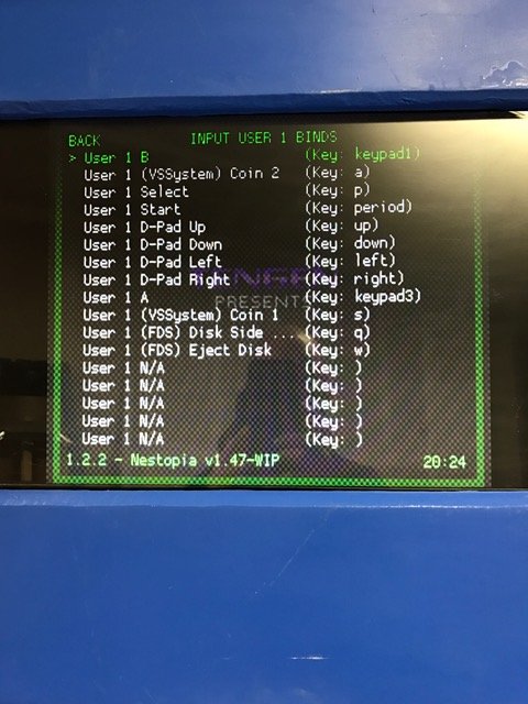

macrho Posted April 13, 2017 Posted April 13, 2017 Where exactly does one change the Bind Mode to RetroKeyboard?
