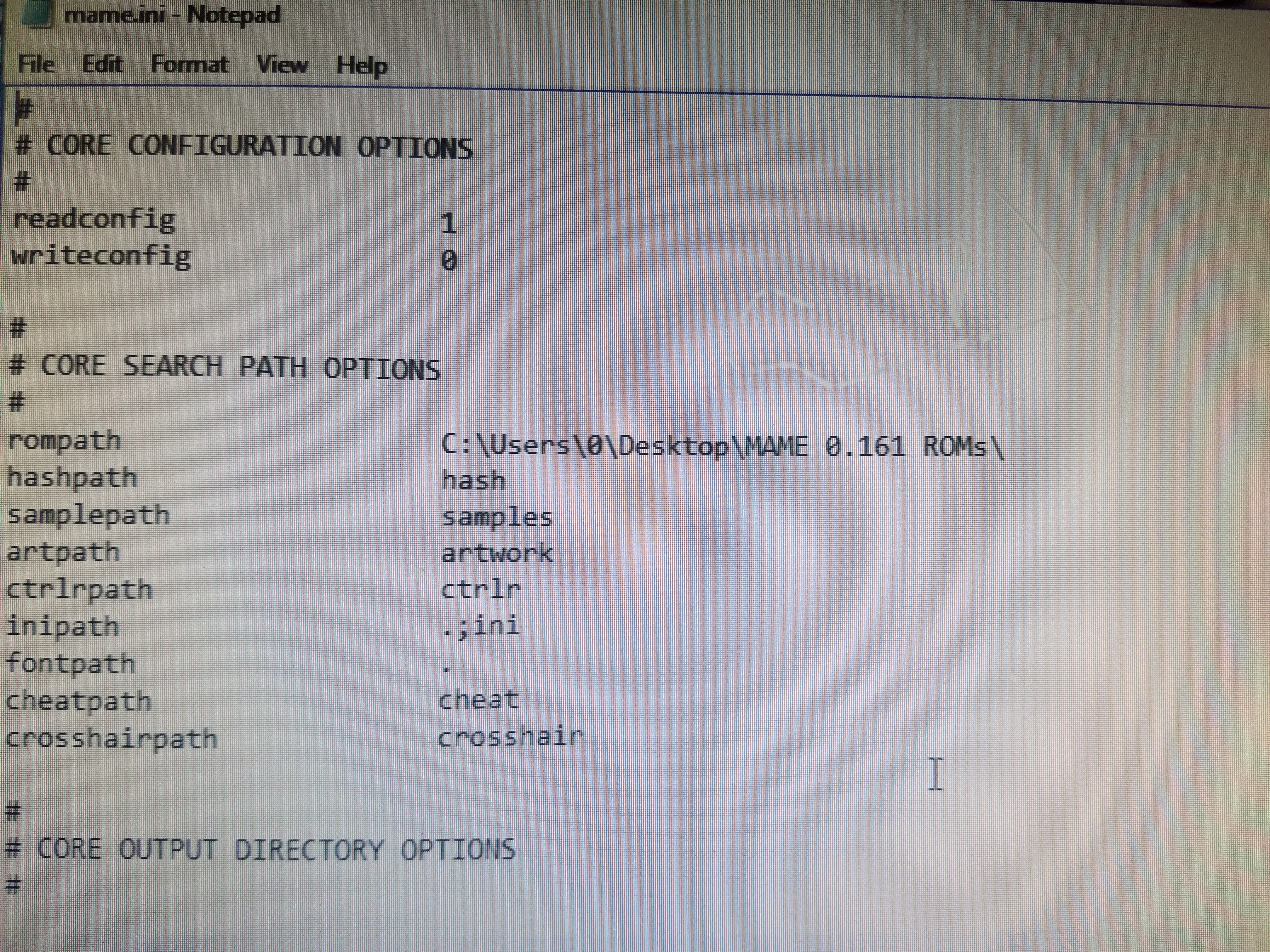

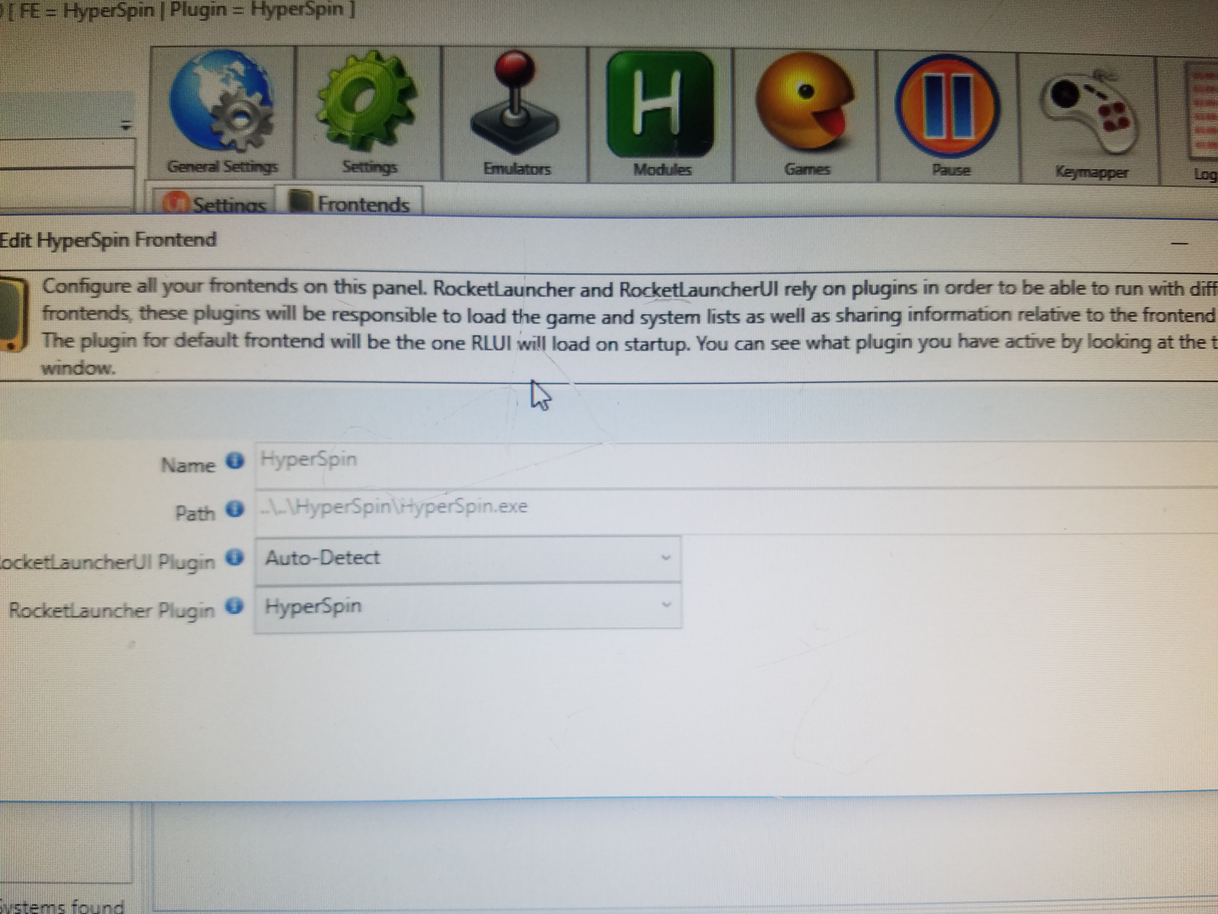

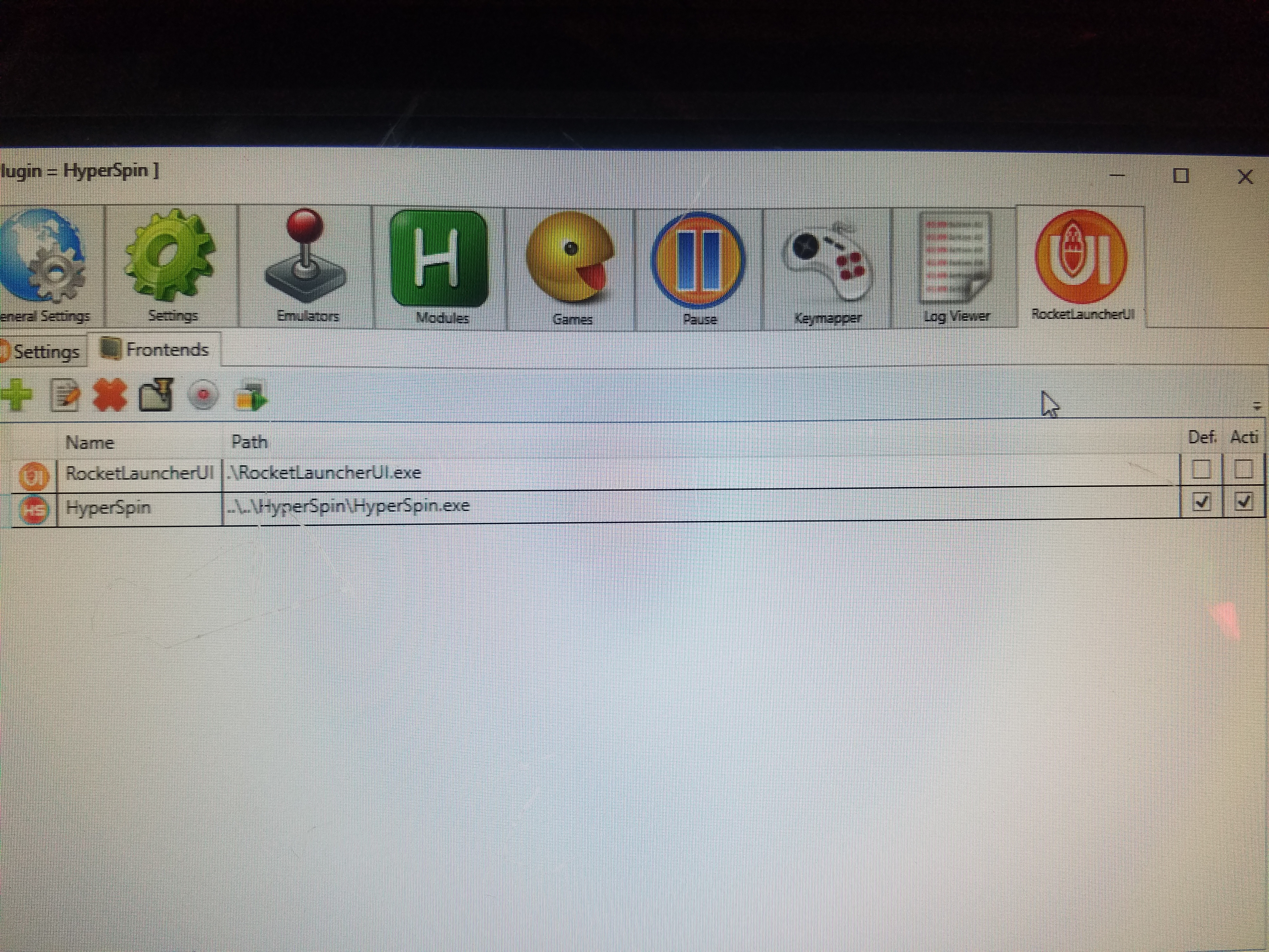

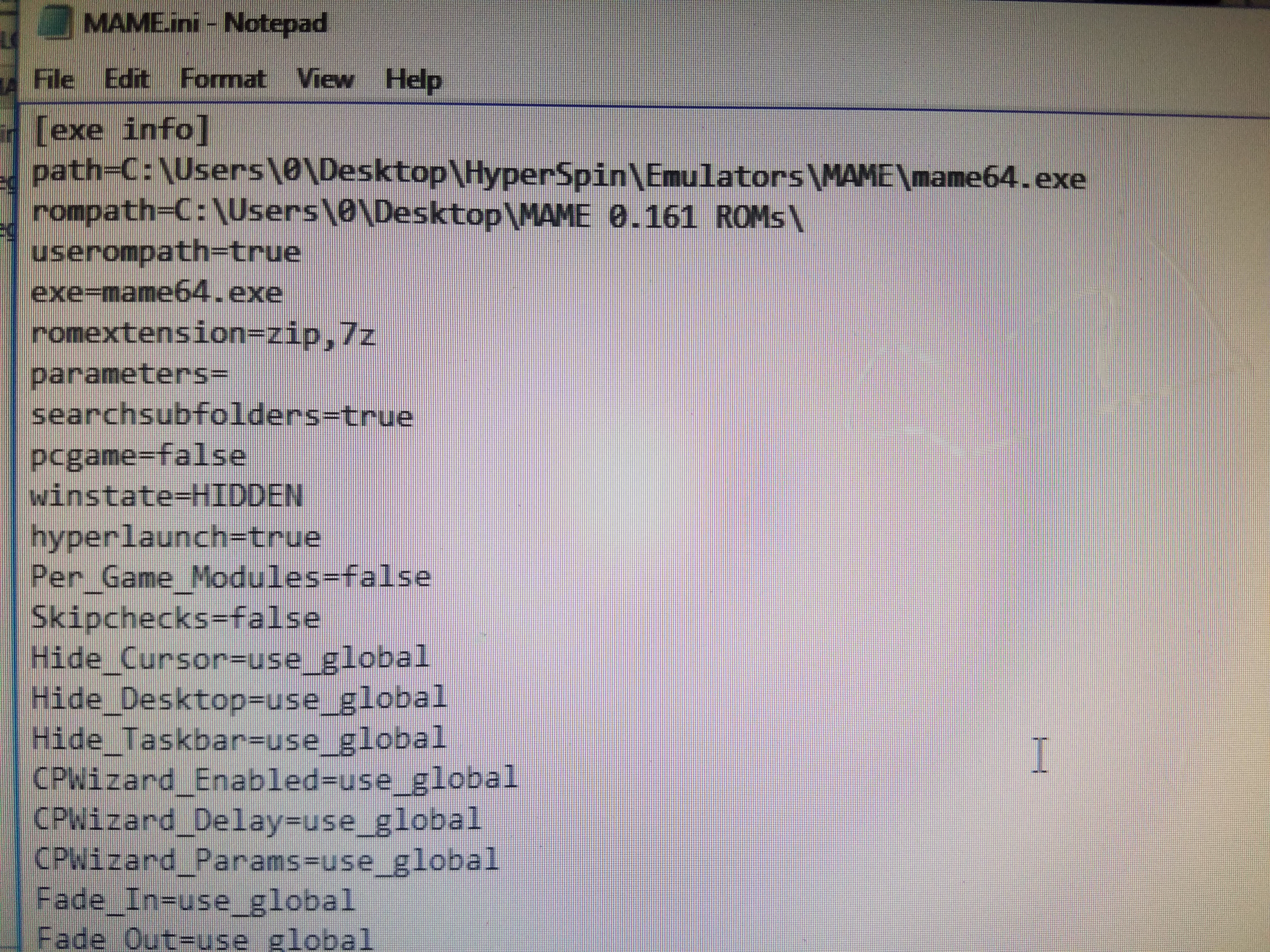

jokerz4fun Posted February 14, 2017 Posted February 14, 2017 Hey guys, I'm running into a small issue with Hyperspin not loading my MAME ROM's. I have read other people having the same issue and I have followed what people have suggested EXCEPT using the renaming tool to remove the file extension on the rom's. I wasn't sure if I should still do that with seeing that the forum date was over a year ago. Also the two videos I watched from from game room solutions and Simply Austin doesn't mention doing that. I have also included a few snapshots of my .ini files just in case I screwed something up. The rom's also work in RocketLauncher with no issue. Let me know what it could possibly be and thanks guys for the help.
jokerz4fun Posted February 14, 2017 Author Posted February 14, 2017 1 hour ago, agent47 said: The Hyperlaunch_Path in your HyperSpin/Settings/Settings.ini needs to be pointing to the RocketLauncher.exe instead of just the folder. Thank you so much. Ill go give that a shot
jokerz4fun Posted February 14, 2017 Author Posted February 14, 2017 So I tried both RocketLauncherUI.exe and just RocketLauncher.exe and still having the same problem
jokerz4fun Posted February 14, 2017 Author Posted February 14, 2017 Here ya go! 06:35:23 PM | HyperSpin Started 06:35:23 PM | Going FullScreen 06:35:23 PM | Checking for updates 06:35:23 PM | Update Check Complete 06:35:23 PM | Startup program unavailable 06:35:23 PM | Playing intro video 06:35:28 PM | Error intializing joysticks 06:35:28 PM | Menu Mode is multi 06:35:28 PM | Loading Main Menu.xml 06:35:28 PM | Main Menu.xml successfully loaded 06:35:28 PM | Main Menu wheel loaded successfully 06:35:29 PM | Loading MAME.xml 06:35:29 PM | Main Menu.xml successfully loaded 06:35:30 PM | MAME wheel loaded successfully 06:35:30 PM | Launching Game 06:35:30 PM | Using HyperLaunch 06:35:30 PM | Getting Launcher path 06:35:30 PM | Can't find HyperLaunch, defaulting to root HyperLaunch.exe 06:35:30 PM | Launcher located at C:\Users\0\Desktop\HyperSpin\HyperLaunch.exe 06:35:30 PM | Running Launcher 06:35:30 PM | Launcher Command Line is: C:\Users\0\Desktop\HyperSpin\HyperLaunch.exe "MAME" "bublboblr" 06:35:32 PM | Launching Game 06:35:32 PM | Using HyperLaunch 06:35:32 PM | Getting Launcher path 06:35:32 PM | Can't find HyperLaunch, defaulting to root HyperLaunch.exe 06:35:32 PM | Launcher located at C:\Users\0\Desktop\HyperSpin\HyperLaunch.exe 06:35:32 PM | Running Launcher 06:35:32 PM | Launcher Command Line is: C:\Users\0\Desktop\HyperSpin\HyperLaunch.exe "MAME" "bublboblr" 06:35:36 PM | Launching Game 06:35:36 PM | Using HyperLaunch 06:35:36 PM | Getting Launcher path 06:35:36 PM | Can't find HyperLaunch, defaulting to root HyperLaunch.exe 06:35:36 PM | Launcher located at C:\Users\0\Desktop\HyperSpin\HyperLaunch.exe 06:35:36 PM | Running Launcher 06:35:36 PM | Launcher Command Line is: C:\Users\0\Desktop\HyperSpin\HyperLaunch.exe "MAME" "bublboblr" 06:35:38 PM | Loading Main Menu.xml 06:35:38 PM | Main Menu.xml successfully loaded 06:35:39 PM | Main Menu wheel loaded successfully 06:35:42 PM | Exit program unavailable 06:35:42 PM | Quiting Hyperspin 06:35:42 PM | Bye! log.txt
jokerz4fun Posted February 15, 2017 Author Posted February 15, 2017 My god man it took you and a picture to figure it out. I never had the folder name just the exe. So it was looking for the exe on my desktop and not the folder first. Thank you so much.
