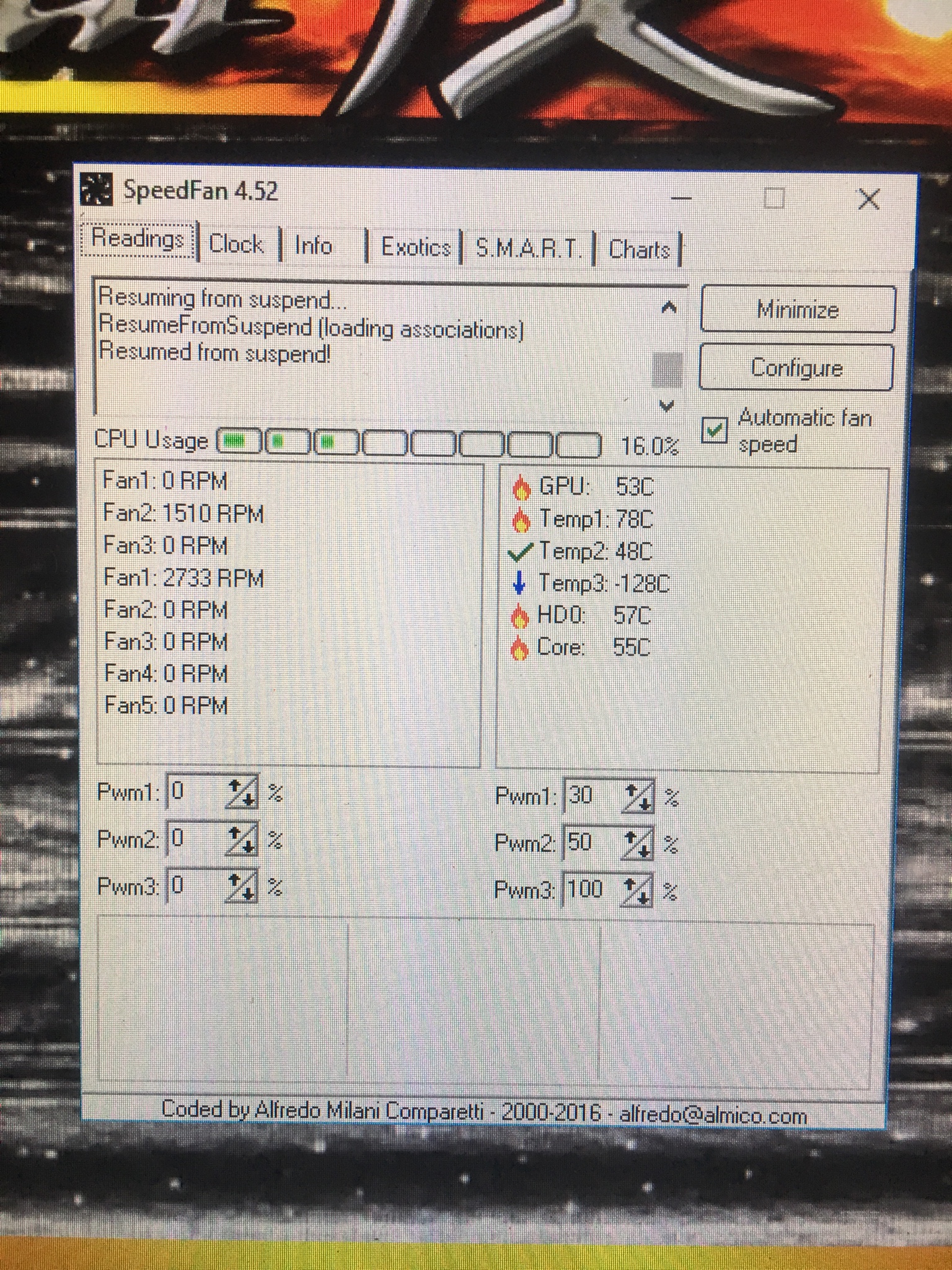

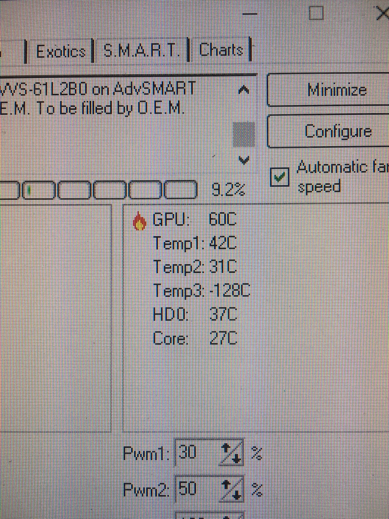

Infbuckets1 Posted February 24, 2017 Posted February 24, 2017 Hey guys, I am brand new to posting on this forum but I recently bought a custom hyperspin 2 player cabinet, and ive had a couple issues that I cant seem to figure out. 1. If I open hyperspin and start playing right away, everything works fine. But If I open and leave it on for 10-20 minutes as you can see in the video, it becomes unresponsive to anything. I have to forcequit and open again. 2. As soon as I open hyperspin to run, all of my fans automatically kick in to overdrive including my 850 watt corsair power supply it would seem that my computer is definitely powerful enough to run this with ease. I put pictures of #s before opening HS and #s after opening HS. Can anyone help a newbie! Thanks Jordan IMG_2008.MOV

jfp Posted February 24, 2017 Posted February 24, 2017 Can't say about the fans.. try setting everything on auto then run your most intensive game to check temp readings
Infbuckets1 Posted February 24, 2017 Author Posted February 24, 2017 Yah you were right about the hd, it shut off in 20 min. So i set to never for now to try. I also set it to automatic fans. Will test mkx or sfV and see what happens! Thank youSent from my iPhone using Tapatalk
Infbuckets1 Posted February 24, 2017 Author Posted February 24, 2017 Gpu is running at 60C In MK XSent from my iPhone using Tapatalk
Infbuckets1 Posted March 2, 2017 Author Posted March 2, 2017 So i turned my hd sleep off and im still running into the same issue. Ive left hyperspin on for an hour without even touching any games and just on the main screen, #1 its burning up and #2 its unresponsive to touch and i have to force quitSent from my iPhone using Tapatalk
jfp Posted March 2, 2017 Posted March 2, 2017 Ya 78 is way 2 high. Cnt say about the unresponsive buttons.. Could be anything.. Check your task manager to see if anything is eating your ram.. Sent from my Q718B using Tapatalk
