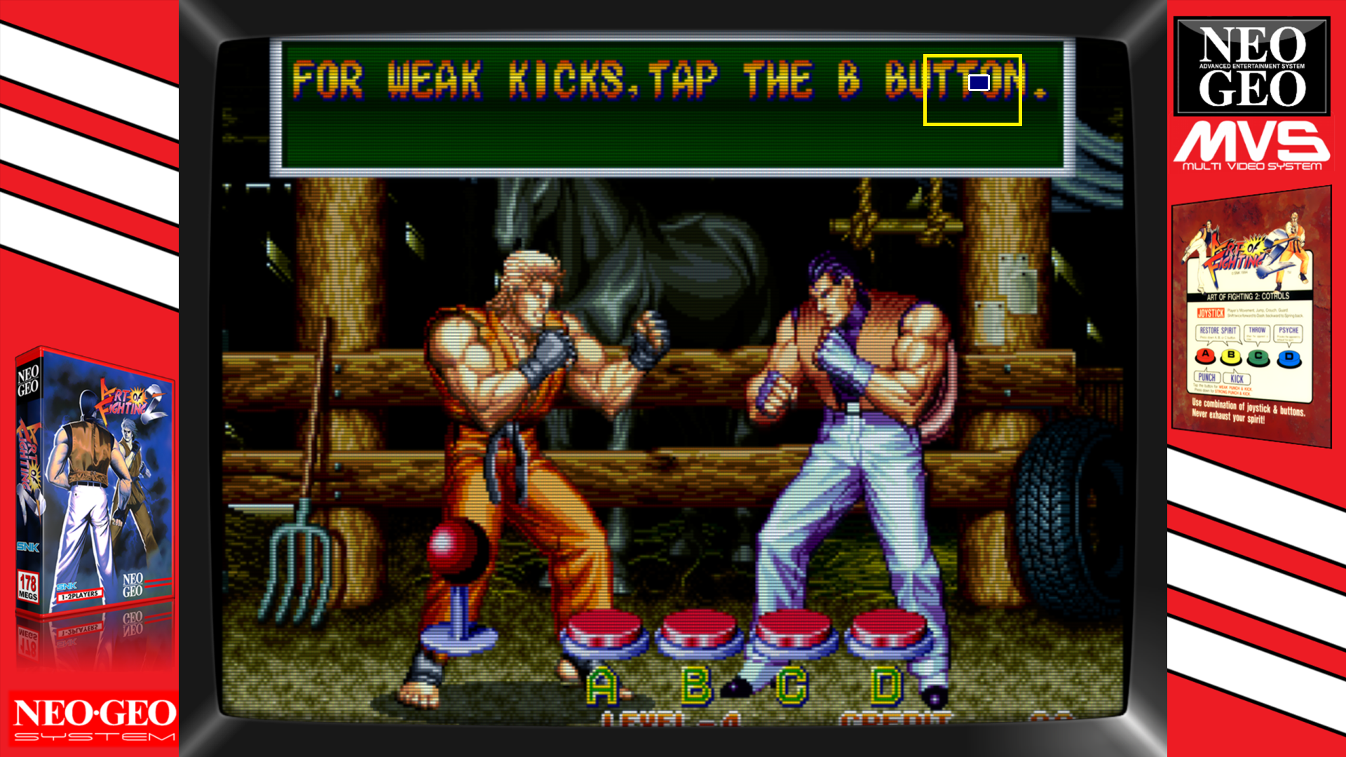

 [ Test Game - csume64.exe aof2 ]
- Blue box is Netstats
- Remove Key is 'N'
