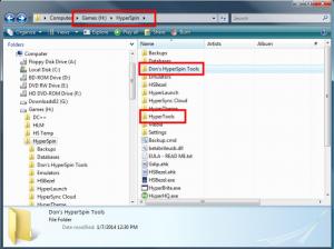

Download the latest stable version of Don's HyperSpin Tools from this thread (Dons-HyperSpin-Tools-4.2.6.zip): http://www.hyperspin-fe.com/forum/showthread.php?20141-Don-s-HyperSpin-Tools-3-0!
Download the newest beta of Don's HyperSpin Tools from this thread (HyperTools-4.3.25.zip): http://www.hyperspin-fe.com/forum/showthread.php?20141-Don-s-HyperSpin-Tools-3-0!&p=290780&viewfull=1#post290780
Extract the directory in the zip files into your HyperSpin folder. The v4.2.6 folder name is 'Don's HyperSpin Tools' and the v4.3.25 folder name is 'HyperTools':

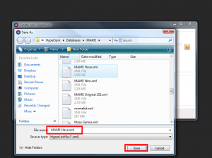

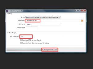

First run the Create new HyperList (folder HyperTools) to get the list of roms you have:
I called this one MAME Have.xml:

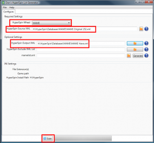

Once it's generated, close out the List Generator and open up Dons HyperSpin List Generator (folder Don's HyperSpin Tools).
Choose the MAME wheel from the drop down box. Select your Official MAME xml as your Source. Then in Optional Settings, the Output XML will be the MAME Have.xml. If you have one, point to your mamelist.xml also, otherwise when you scan, it will create one for you. Then click the Scan button.

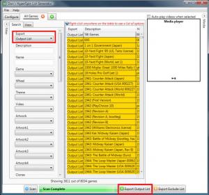

It will ask if you want to generate a mamelist.xml. Once scanned, you will see this screen:

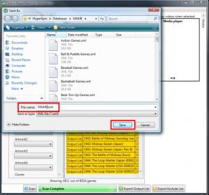

Click the drop down box that says Export to say Output List. Lastly, at the bottom hit the Export Output List button. It will ask to name and save your new fully populated xml for MAME. If you have backed up your existing MAME.xml, call it that and hit the Save button:
That's it! Your new MAME.xml is fully populated with all the extra tags, but only includes the roms you have.
