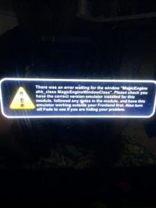

Hello, I am more than happy with hyperspin. I am having trouble setting up one of my emulators. Magic Engine 1.0 works great as a window, but when I full screen it or run it in hyperlaunch the music is sped up and I get this error message. I tried using Magic Engine 1.3 but I don't like having a time limit, so I will upgrade if I have to. Thanks for the help.

[ATTACH=CONFIG]40230[/ATTACH]
You may be getting that error because the supported emulator version is 1.1.3. not version 1.0. When the emulator starts, Hyperlaunch looks for the window which has a name, if it doesn't find the window with the correct name, you get an error.
The solution is to either use the supported Emulator or change the relevant part of the ahk script.
