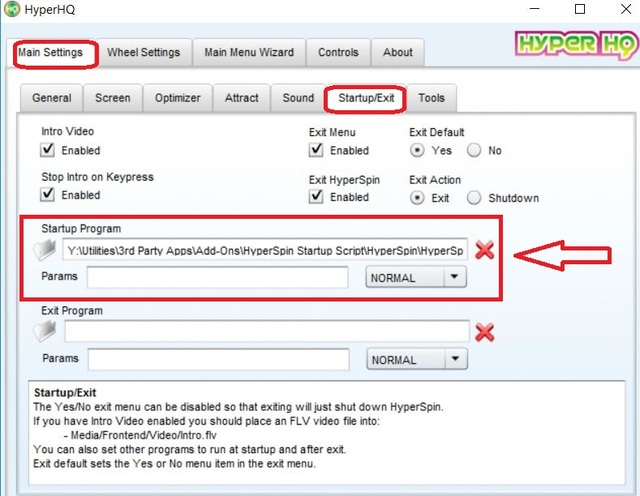

Hi, for to load a profile when you open HyperSpin, you need to launch HyperSpin Startup Script
Choose the aplicattion from HyperHQ in Main Settings/Startup-Exit/Startup Program:
This is my config of Startup Script of HyperSpin:
