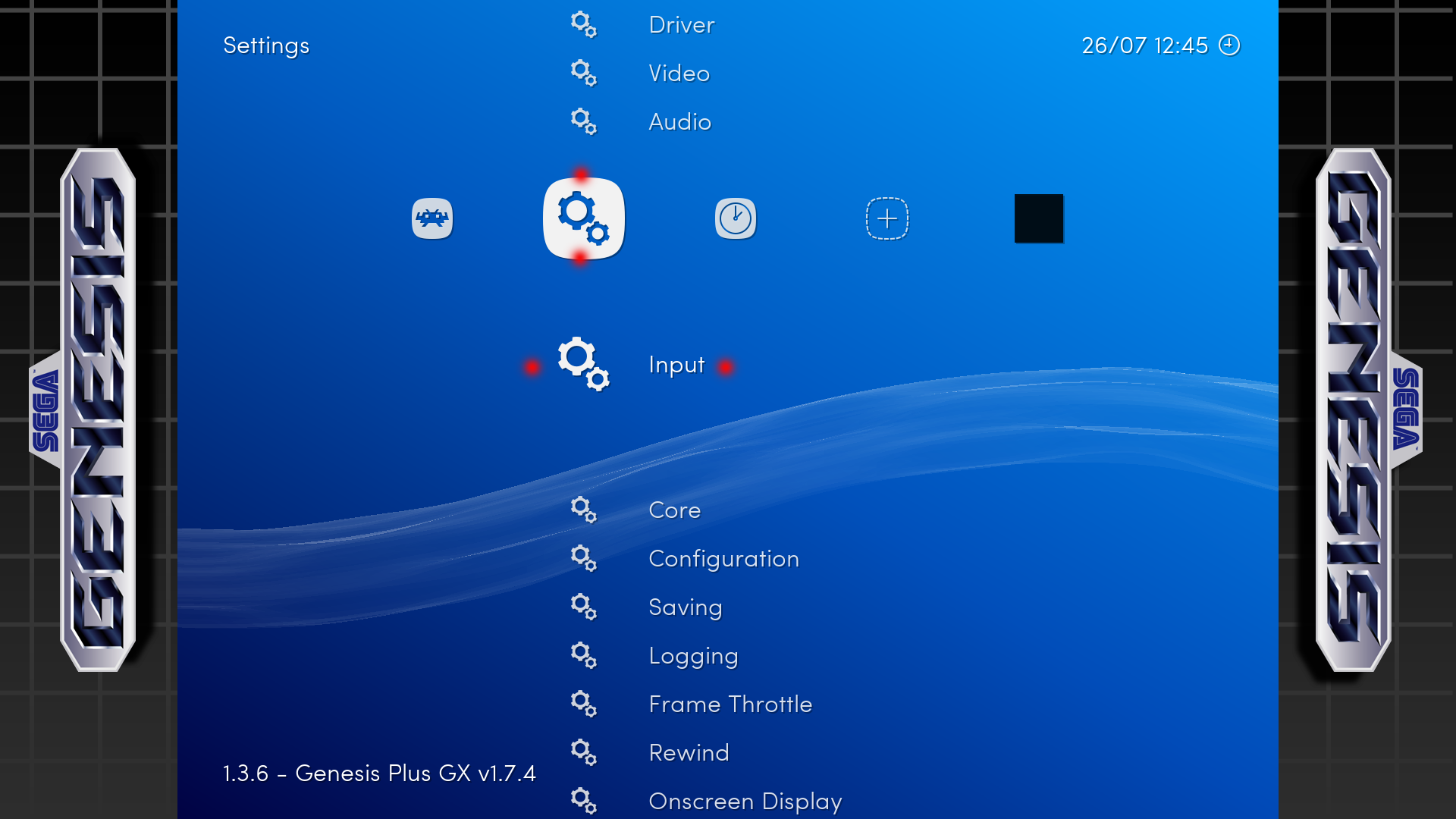

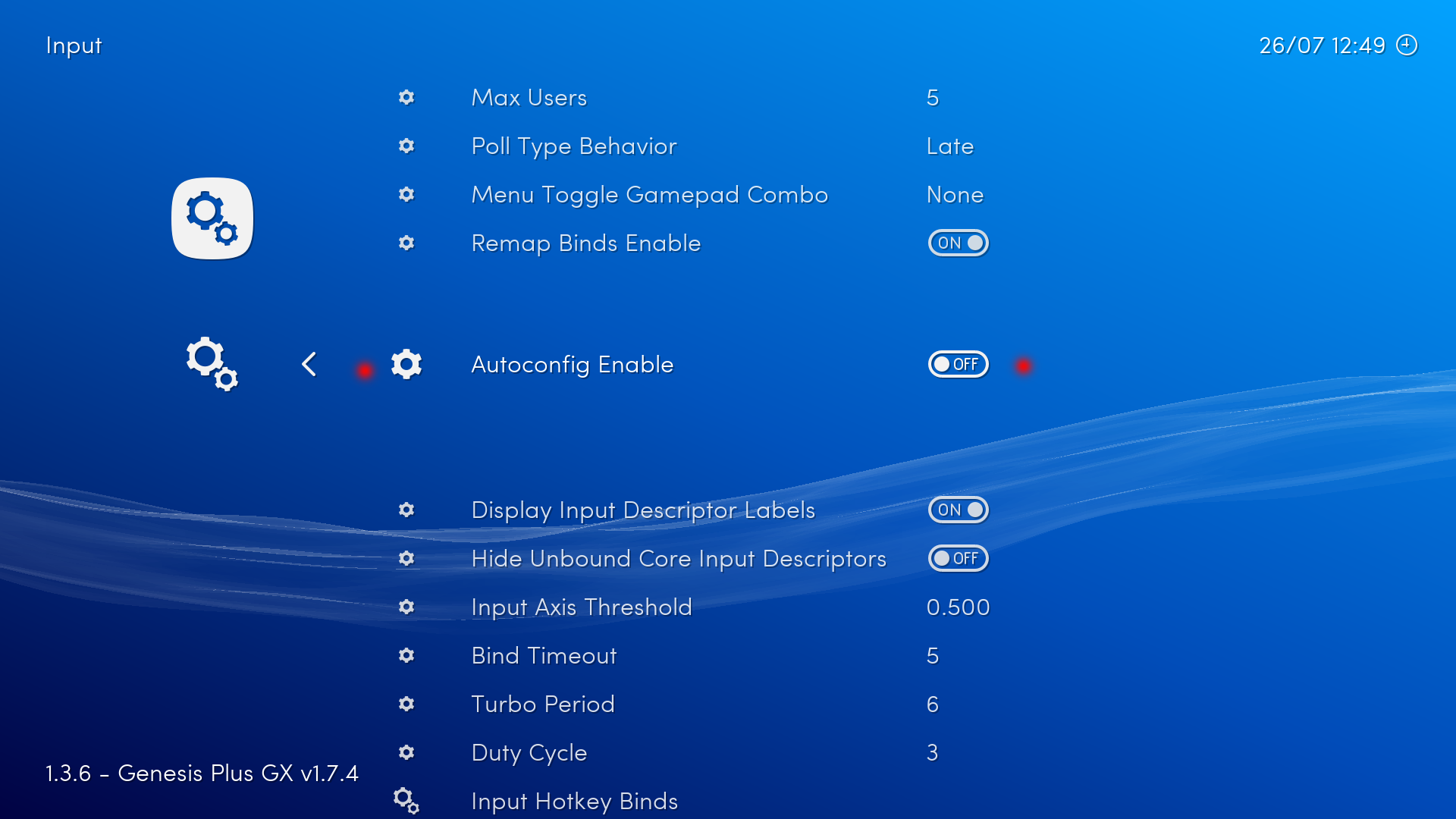

gigapig Posted July 26, 2017 Posted July 26, 2017 First of please do not edit your post with important information if you want people who are following to see it. If you create a new post then the people following will be emailed. Below are the steps I take when remapping controls on my cab for my Ultrastiks, it also assumes that you have per system configs set up. So run a game for the system you are setting, here I chose Sega Genesis. Hit F1 to enter the menu and move across to settings and then input. In the next shot I have disabled "AutoconfigEnabled" as this worked for me, but may be different for others. Scroll down to the User Input Binds 1 and hit the X key to enter. In the next menu you should see your controller listed maybe as Xinput, if it's not listed then maybe RetroArch has not detected it, try cycling through the options. I used an Xbox360 controller for this test. Now you will see the inputs for the Genesis controller on the left, so User 1B is the player 1 B button on the original Genesis controller. To the right of that is the button or keyboard assignment for your controller. Highlight this and press X to remap the button. Do the same for the other inputs and then scroll up to "User1 Save Autoconfig". That should be all you need to do unless you want to add players. As I may have said already, you don't normally have to remap controls if using an Xinput controller as they should already be set up. Please also make a back up of your configs before changing them.
