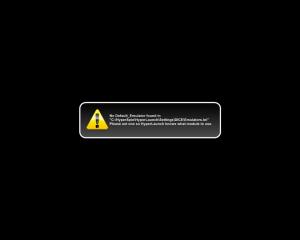

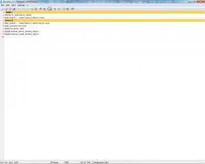

relic Posted April 27, 2014 Posted April 27, 2014 hi guys so i set up my emulators etc in hyperlaunch hyperlaunch runs them great but when i run them in hyperspin it gives me a simple error an unknown one even so my settings . inis look normal i have no idea whats up the only thing i can think of is cause ive named my folder diffrent rather then hyperspin it seems to be looking for the orginal hyperspin folder which mine is set as this Hyperspin 2014 Belive The Hype rather then this HyperSpin and its doing it will all my machines ive setup through hyperlaunch. my set up .ini dice emu it turns out it was pointing to the wrong hyperlaunch simple fix if you guys get stuck this is how to fix it im a noob for not spoting it in teh first place lsd spoted it straight out mine was set like thiis Hyperlaunch_Path=C:\Hyperspin\HyperLaunch\ where it should have been set like this Hyperlaunch_Path=C:\Hyperspin 2014 Belive The Hype\HyperLaunch\ 100%
ghutch92 Posted April 27, 2014 Posted April 27, 2014 you may want to change it again. The word "Belive" doesn't look correct, it's almost out of place. I'm glad you identified your error. For search and replace text jobs in separate files I like to use notepad++'s find and replace feature. How to Install HyperSpin and more RocketLauncher HyperSpin Startup Script
