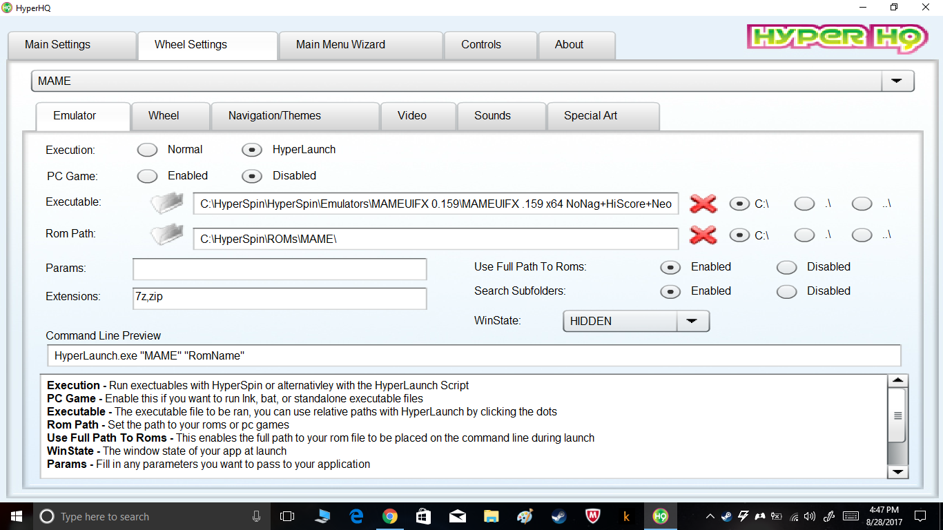

GameShark813 Posted August 28, 2017 Author Posted August 28, 2017 Here's my paths in HyperHQ I'm using MAMEUIFX I'm not sure if I have a .ini file or where it is. I tried to make one but it didn't work out. Sorry to be a pain once again.
gigapig Posted August 28, 2017 Posted August 28, 2017 Try setting "execution" to normal, at the moment it's using Hyperlaunch which you are not using.
GameShark813 Posted August 28, 2017 Author Posted August 28, 2017 When I have that selected and try to launch a game through HyperSpin, nothing happens and I can't even exit out of HyperSpin.
