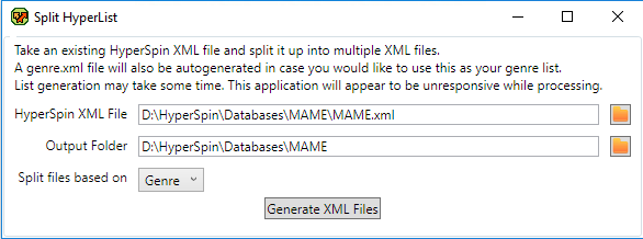

ci2own Posted September 10, 2017 Posted September 10, 2017 You can do it using Split HyperList from Dons Tools. Download the mame.xml you want (mahjong, nomahjong, casino, no casino, etc) and split it into genres with this tool.
demonseed Posted September 10, 2017 Author Posted September 10, 2017 Ci2own! that was how I did it last time.. thanks that will work!!... I will check the folder in name to see I have genre.xml
demonseed Posted September 11, 2017 Author Posted September 11, 2017 Hey I redownloaded the XML and all works great! Thanks so much for the help.
