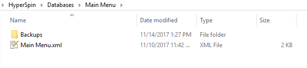

Bungles Posted November 14, 2017 Posted November 14, 2017 Check your Main Menu.xml Database file preferably in Notepad++ Make sure that the formatting is all ok and that... <game name="MAME"/> is still there... Sometimes when using packs you can clear/override your database files. Always be sure to take a backup (They aren't usually that big.) Hope that helps any. Retro Cafe - Universal ThemeHyperControl - Main Menu Config and Apps WheelAudiocade - Main Menu Music PlayerTelltale Games WheelPCGamers Top 100 PC Games 2014 WheelMGS HD Exit Screen8-Bitdo Special ArtAll Contributions My Youtube Channel - https://www.youtube.com/user/3ungle

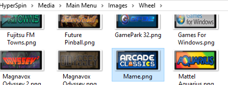

Jhailson Posted November 14, 2017 Author Posted November 14, 2017 Thanks for the reply. I looked at the Main Menu.xml, and it is listed, the same as you showed. The last thing I remember doing before it disappeared is, I was coping images etc to folders in hyperspin; Is it possible I may have overwritten or deleted my mame picture for the wheel? Which folder would that be in?
Bungles Posted November 14, 2017 Posted November 14, 2017 That would be in Media/Main Menu/Images/Wheels.. Should be called MAME.png if all is default. Retro Cafe - Universal ThemeHyperControl - Main Menu Config and Apps WheelAudiocade - Main Menu Music PlayerTelltale Games WheelPCGamers Top 100 PC Games 2014 WheelMGS HD Exit Screen8-Bitdo Special ArtAll Contributions My Youtube Channel - https://www.youtube.com/user/3ungle

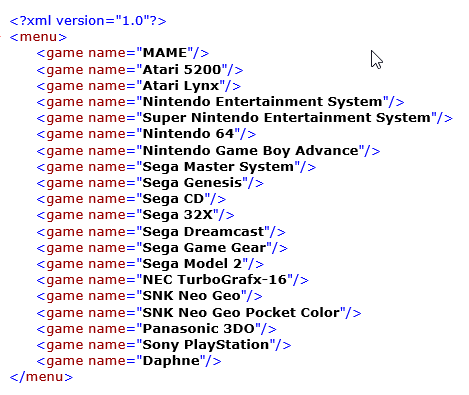

nikkisixx Posted November 14, 2017 Posted November 14, 2017 If you overwritten or deleted the mame.png logo, you still may see it, but without imagen, just plain text. Can you show us the content of the "main menu.xml" database?
Jhailson Posted November 14, 2017 Author Posted November 14, 2017 So after some playing around replacing image files the wheel option is back. However, when I stop on the mame or arcade classics if defaults to NES.
Jhailson Posted November 17, 2017 Author Posted November 17, 2017 I was able to fix this, I had to replace the image. Thanks for the helpful replies.
