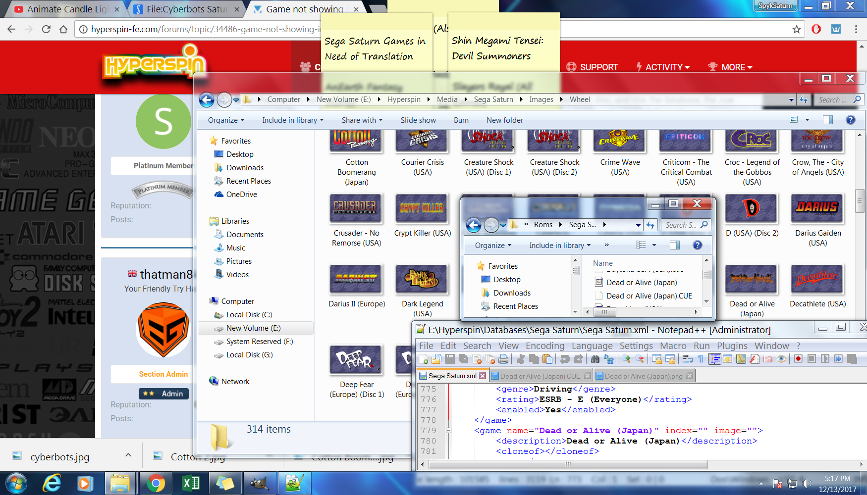

SpykSaturn Posted December 13, 2017 Posted December 13, 2017 So dead or alive will not show in hyperspin for the sega saturn. It shows up in rocket launcher just fine but I got nothing in hyperspin. I have checked the names for spacing, capitalization, and spelling in the wheel art for the case, disc, and title, the database, the .cue file and probably anywhere else I could possibly think of. I can load the game through rocket launcher but it fails to show up in hyperspin. Only game I am having an issue with. Any clue? Also I have tried renaming every file just in case.
thatman84 Posted December 13, 2017 Posted December 13, 2017 Double double check the rom name and database entry are exactly the same. Once you have at least the default wheel text showing you can move on. Capitalization extends to the file extension also. Chamge your file explorer to show extensions if it does not already. Hyperspin 2.0 Latest Download Hyperspin 2.0 Documentation -------Pre Hyperspin 2.0 Below---------- HS Android Overview & Install HS Android Base Pack Download My Tutorials
SpykSaturn Posted December 13, 2017 Author Posted December 13, 2017 This is my double double check. Where else could I be going wrong. Again the game shows in rocket launcher fine, plays in rocket launcher fine, but will not show up in Hyperspin when I go to the Sega Saturn wheel. All other games you see in the background do. I hope this is just something stupid I am not seeing that you can point out to me but I have been itching my head on this one for some time now. Any other info needed let me know and I will be glad to comply. :Edit: Just something to add, I have tried renaming each and every file multiple times.
Guest hellsing001 Posted December 13, 2017 Posted December 13, 2017 Could be a because its a capital CUE, add that to the file types in HYPERHQ, next to zip, cue. Also check the cue file in notepad to see if its looking for the correct bin file. hellsing
SpykSaturn Posted December 13, 2017 Author Posted December 13, 2017 2 minutes ago, hellsing001 said: Could be a because its a capital CUE, add that to the file types in HYPERHQ, next to zip, cue. Also check the cue file in notepad to see if its looking for the correct bin file. hellsing Genius cant believe i overlooked this. thanks!
