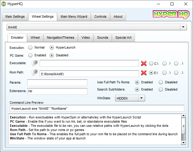

Bungles Posted December 16, 2017 Posted December 16, 2017 Well thats a Rocket Launcher Error it seems. I would say Check the path and the filename match, also maybe add the extensions in the Hyperspin wheel settings. Also That's a lot of extensions by the way! For Mame all you need is zip or 7z depending on your files I think. Maybe chd also in some cases.. This is mine and its working fine for the games I have tried so far... Retro Cafe - Universal ThemeHyperControl - Main Menu Config and Apps WheelAudiocade - Main Menu Music PlayerTelltale Games WheelPCGamers Top 100 PC Games 2014 WheelMGS HD Exit Screen8-Bitdo Special ArtAll Contributions My Youtube Channel - https://www.youtube.com/user/3ungle
Bungles Posted December 16, 2017 Posted December 16, 2017 Also I think its a comma , to separate not a vertical line | Retro Cafe - Universal ThemeHyperControl - Main Menu Config and Apps WheelAudiocade - Main Menu Music PlayerTelltale Games WheelPCGamers Top 100 PC Games 2014 WheelMGS HD Exit Screen8-Bitdo Special ArtAll Contributions My Youtube Channel - https://www.youtube.com/user/3ungle

syborfical Posted December 16, 2017 Author Posted December 16, 2017 44 minutes ago, agent47 said: All the OP needs to do to fix the issue is set the Skip Checks to Rom Only in RLUI on the Settings tab as mentioned in the module notes. Due to the way RL audits roms it's required to have it send the game name instead of the file path otherwise CHD only games, clones when using a merged set (like the one in OP's error), and other games without standard rom files will not run. Thank You Works great :-) here is how to fix it...
