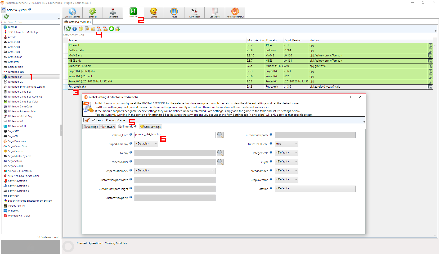

Suhrvivor Posted December 17, 2017 Posted December 17, 2017 You need to change the module of Retroarch in Rocketlauncher using RocketlauncherUI. Here's a capture to guide you:
Mscromer Posted December 17, 2017 Author Posted December 17, 2017 Thank Both of u so much GREAT capture there Suhrvivor. thats the kind of stuff i need while learning all this.
