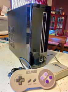

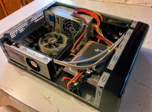

Rick74 Posted May 2, 2014 Posted May 2, 2014 Here's my dedicated Emulation PC... Hooked up to a 67" DLP i3-4340 Asus H87i-Plus Mini ITX WD Blue 1TB Seagate 240gb SSD Corsair Vengeance Low Profile 8gb (2x4gb) Seasonic 350 watt TFX PSU Diamond Radeon 7750 Low Profile Single Slot GPU
