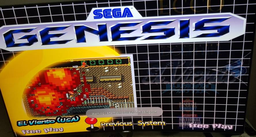

bader990 Posted January 12, 2018 Posted January 12, 2018 Hi what are its settings hyperspin nvidia shield controller setup select and start button I can not start playing What is the way please Please help me I'm not an expertThere is a message in the screen Warning تم الإرسال من SM-N950F باستخدام Tapatalk

thatman84 Posted January 13, 2018 Posted January 13, 2018 Check you file extensions match in the settings file for Sega Genesis. Case sensitive make sure your rom path is correct with exact capitals etc also all rom files in one folder NO subfolders allowed Hyperspin 2.0 Latest Download Hyperspin 2.0 Documentation -------Pre Hyperspin 2.0 Below---------- HS Android Overview & Install HS Android Base Pack Download My Tutorials
bader990 Posted January 13, 2018 Author Posted January 13, 2018 Check you file extensions match in the settings file for Sega Genesis. Case sensitive make sure your rom path is correct with exact capitals etc also all rom files in one folder NO subfolders allowed rom path settings file for Sega Genesis https://up.top4top.net/downloadf-743qrl851-rar.html تم الإرسال من SM-N950F باستخدام Tapatalk
bader990 Posted January 15, 2018 Author Posted January 15, 2018 Is there an errorتم الإرسال من SM-N950F باستخدام Tapatalk
