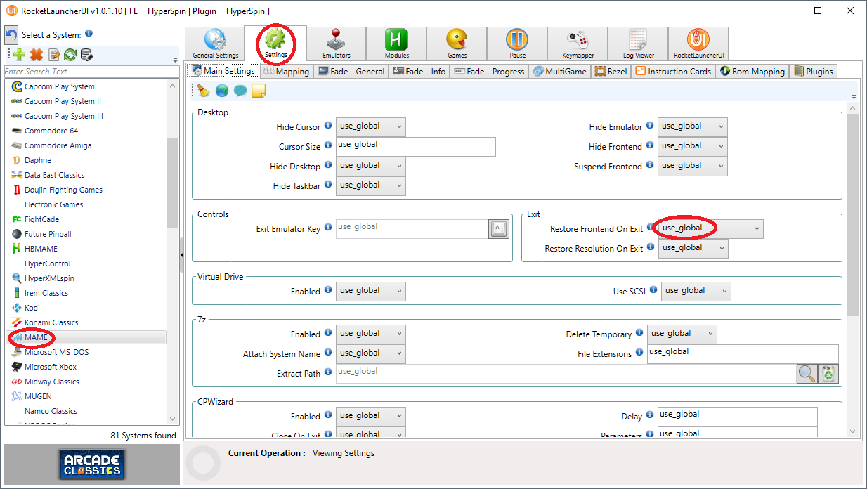

Bungles Posted March 5, 2018 Posted March 5, 2018 You boot the game via Rocketlauncher you say. Would not one think that when exiting the game it might also have something do with your launcher and not front end. Maybe if there was a UI.exe for your launcher to investigate the settings for your Mame. Even then setting an option of sorts of what to do when exiting a game, in regards to Hyperspin as your Default and Active Front End. And if Sarcasm is lost. Picture! As for Launching MAME and then having it skip any boot messages and/or wait until loaded to show visuals.. that's another story, and a whole lot more pictures. Retro Cafe - Universal ThemeHyperControl - Main Menu Config and Apps WheelAudiocade - Main Menu Music PlayerTelltale Games WheelPCGamers Top 100 PC Games 2014 WheelMGS HD Exit Screen8-Bitdo Special ArtAll Contributions My Youtube Channel - https://www.youtube.com/user/3ungle
BlackWidow Posted March 5, 2018 Author Posted March 5, 2018 Your reply was like a footnote from The Hitchhiker's Guide to the Galaxy ;-) But it did sort of throw me in the right direction and I got it working. In the HyperHQ startup options I linked to a bat file I created with the following: start D:\Arcade\RocketLauncher\RocketLauncher.exe "Daphne" "lair" Thought Dragon's Lair was a nice attract screen, as opposed to a MAME game. So, yeah, thanks I guess, Ford Prefect!
