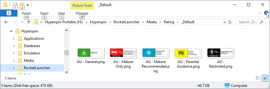

Then as I use Rocketlauncher in the RocketLauncher/Media/Ratings/_Default folder I have these images. (Default usually has more but not these for my AU Region.)
Note: The images names must match the rating you are using for the region you are using. These are Case Sensitive also I do believe.
So when I load a game via Hyperspin, Rocketlauncher as the launcher matches the rating in the database to the image files above and I get this embedded in my Intro Screen.

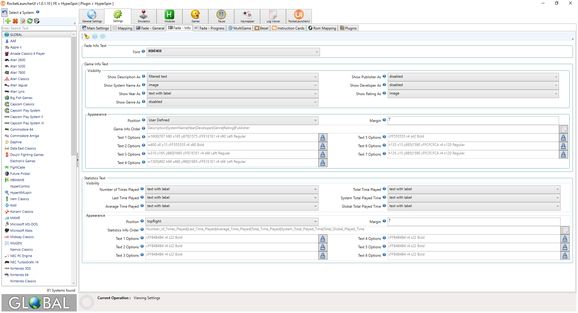

The below is my default settings for Rocketlaucher Fades if it helps also.
You can see Show Rating As "Image" is selected, Pretty sure you can just show it has text also.
