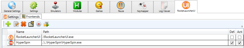

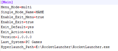

Bungles Posted April 18, 2018 Posted April 18, 2018 Welcome, Sort of looks like Hyperlaunch is being used instead of Rocketlauncher still. Check your Settings.ini file in the Hyperspin/Settings folder and be sure that Rocketlauncher.exe is set in your default Hyperlaunch_Path. Also check in RocketlauncherUI that Hyperspin is your Default and Active Front End. However if other systems are working from Hyperspin ... hmm. Retro Cafe - Universal ThemeHyperControl - Main Menu Config and Apps WheelAudiocade - Main Menu Music PlayerTelltale Games WheelPCGamers Top 100 PC Games 2014 WheelMGS HD Exit Screen8-Bitdo Special ArtAll Contributions My Youtube Channel - https://www.youtube.com/user/3ungle

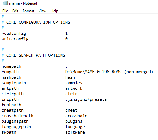

qualx Posted April 18, 2018 Author Posted April 18, 2018 Thanks Bungles! So both are already set as you mentioned, I did figure out I was missing my mame ini file, so I created it, and set my rom path, this seemed to get me further but now it just hangs at the loading splash screen of any rom I load. Any other ideas? Edit: here is an imgur link to my screenshots to make it a bit easier to see https://imgur.com/a/0WRdwyr

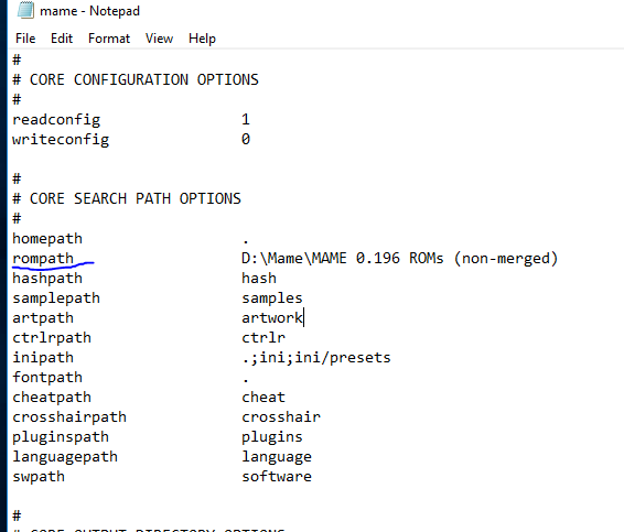

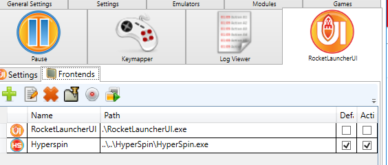

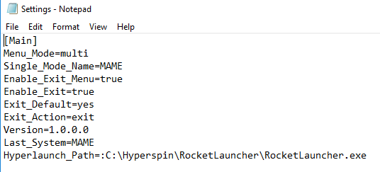

qualx Posted April 19, 2018 Author Posted April 19, 2018 Hi so this is fixed now! In case anyone else has this issue here is what I needed to do to fix it step by step, hope this helps some other poor soul who gets stuck in my position. First, I did not create my Mame ini file, if you need to create one and don't know how: 1. Open a CMD prompt, and change your directory to your mame emulator folder so in my case I had to run it as follows cd C:\Hyperspin\HyperSpin\Emulators\Mame (you'll need to replace the directory with where your MAME emulator is) Then run this command to create the ini mame.exe -cc This will create a mame config file in the same mame directory Open your ini file and add your rompath Once that was done I was able to open my roms, but I could only open one mame rom at a time without having to fully close hyperlaunch.exe form my task bar, it seemed to just hang indefinitely disallowing me from opening anything else. The big takeaway is that i'm (supposed to be) using RocketLauncher, not hyperlauncher. long story short my hyperspin settings ini had an extra colon before my rocketlauncher path and that was causing rocketlauncher to not be called and instead hyperlauncher was loading, and not closing when exiting roms. So in case anyone has this god awful issue they can use my poorly worded fix to help them along the way. TIME TO BUILD MY CABINET!
