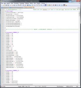

gigapig Posted May 8, 2014 Posted May 8, 2014 What you do is... Set your controls in Demul, if you need different controls for different games you can do them 1 at a time. Open the paddemul.ini and find the entry you just made, possibly [JOY0_0] or [JAMMA0_0] Open up the Demul (v0.5.7).ini found in :\HyperLaunch\Modules\Demul Find the corresponding entry in the ini and copy the entries from the paddemul.ini into the Demul (v0.5.7).ini and save. You can then repeat the process if you use different controls schemes for different games. I hope this helps.
microbytemob Posted May 8, 2014 Author Posted May 8, 2014 thanks for your help worked like a charm!!!
