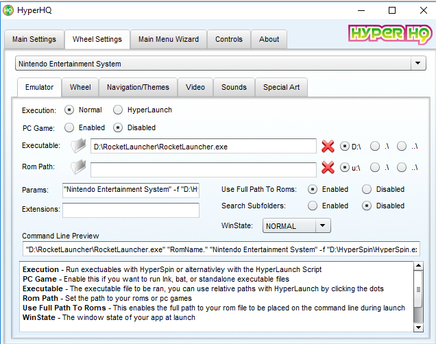

R4messne Posted June 1, 2018 Posted June 1, 2018 Hello All, After the recent update I am having issues launching games from Hyperspin but Rocketlauncher does everything just fine. Below is my log... 04:07:41 PM | HyperSpin Started 04:07:41 PM | Going FullScreen 04:07:41 PM | Checking for updates 04:07:41 PM | Update Check Complete 04:07:41 PM | Startup program unavailable 04:07:41 PM | Error intializing joysticks 04:07:41 PM | Menu Mode is multi 04:07:41 PM | Loading Main Menu.xml 04:07:41 PM | Main Menu.xml successfully loaded 04:07:42 PM | Main Menu wheel loaded successfully 04:07:48 PM | Loading Nintendo Entertainment System.xml 04:07:48 PM | Main Menu.xml successfully loaded 04:07:49 PM | Nintendo Entertainment System wheel loaded successfully 04:07:50 PM | Launching Game 04:07:50 PM | Not using HyperLaunch 04:07:50 PM | Running in normal rom mode 04:07:50 PM | Excecutable is RocketLauncher.exe 04:07:50 PM | Command Line is: "D:\RocketLauncher\RocketLauncher.exe" "Sky Kid (USA)." "Nintendo Entertainment System" -f "D:\HyperSpin\HyperSpin.exe" -p "HyperSpin" 04:07:59 PM | Launching Game 04:07:59 PM | Not using HyperLaunch 04:07:59 PM | Running in normal rom mode 04:07:59 PM | Excecutable is RocketLauncher.exe 04:07:59 PM | Command Line is: "D:\RocketLauncher\RocketLauncher.exe" "Sky Kid (USA)." "Nintendo Entertainment System" -f "D:\HyperSpin\HyperSpin.exe" -p "HyperSpin" 04:08:07 PM | Loading Main Menu.xml 04:08:07 PM | Main Menu.xml successfully loaded 04:08:08 PM | Main Menu wheel loaded successfully 04:08:09 PM | Exit program unavailable 04:08:09 PM | Quiting Hyperspin 04:08:09 PM | Bye! It appears the rom is showing up before the system but I cannot figure out how to fix it. Again games launch fin in RL but not HS. Below is my HS settings. [Main] Menu_Mode=multi Single_Mode_Name=MAME Enable_Exit_Menu=true Enable_Exit=true Exit_Default=yes Exit_Action=exit Version=1.0.0.0 Last_System=MAME Hyperlaunch_Path=D:\RocketLauncher\RocketLauncher.exe Use_Last_Game=false [Resolution] FullScreen=true Width=800 Height=600 Scanlines_Active=false Scanlines_Image= Scanlines_Scale=2 Scanlines_Alpha=0.1 [Optimizer] CPU_Priority=high Quality=BEST Image_Smoothing=true Animated_Backgrounds=true Inter_Backgrounds=false Level1_Backgrounds=true Level2_Backgrounds=true Level3_Backgrounds=true Level4_Backgrounds=true Special_Backgrounds=true Wait_For_Special=false Animated_Artworks=true Level1_Artworks=true Level2_Artworks=true [IntroVideo] Use_Intro=false Stop_On_Keypress=true [Sound] Master_Volume=100 Video_Volume=100 Wheel_Volume=20 Interface_Volume=100 [AttractMode] Active=true Time=300 MaxSpinTime=10 HyperSpin=true Wait_For_Video=false [Keyboard] Key_Delay=true [P1 Controls] Start=13 Exit=27 Up=38 Down=40 SkipUp=37 SkipDown=39 SkipUpNumber=70 SkipDownNumber=86 HyperSpin=32 Genre=71 Favorites=76 [P2 Controls] Start=69 Exit=81 Up=87 Down=83 SkipUp=65 SkipDown=68 SkipUpNumber=74 SkipDownNumber=77 HyperSpin=88 Genre=72 Favorites=90 [P1 Joystick] Enabled=false Joy=0 Threshold=40 Start=Button_6 Exit=Button_5,Analog_Up Up=POV_Up Down=POV_Down SkipUp=Analog_Up SkipDown=Analog_Down SkipUpNumber=Analog_Right SkipDownNumber=Analog_Left HyperSpin=Button_8 Genre=Button_7 Favorites=Button_5 [P2 Joystick] Enabled=false Joy=1 Threshold=40 Start=Button_1 Exit=Button_2 Up=Analog_Up Down=Analog_Down SkipUp=Analog_Left SkipDown=Analog_Right SkipUpNumber=Button_3 SkipDownNumber=Button_4 HyperSpin=Button_5 Genre=Button_6 Favorites=Button_7 [Trackball] Enabled=false Sensitivity=90 [Spinner] Enabled=false Sensitivity=90 [Startup Program] Executable= Paramaters= Working_Directory= WinState= [Exit Program] Executable= Paramaters= Working_Directory= WinState=NORMAL [LEDBlinky] Active=false Path= [HiScore] Active=false Y=550 Delay=2 [HyperLaunch] Last_System=Sega Dreamcast Last_Rom=House of the Dead 2, The (USA) Exit_Script_Key=~q & ~s Exit_Emulator_Key=Esc Toggle_Cursor_Key=t MultiGame_Key=NumpadSub MultiGame_Select_Key=Enter MultiGame_Exit_Key=Esc Path_To_Daemontools= Path_To_CPWizard= Fade_In_Interrupt_Keys=anykey Keymapper_Path= Keymapper_Profiles_Path=C:\Users\lefta\Desktop\hyperspin\Keymapper Profiles\ Any help would be greatly appreciated. I cannot seem to fix it EDIT MY rocketlaunch settings ini even shows the error, see below... [Settings] RocketLauncher_Media_Path=.\Media Modules_Path=.\Modules Profiles_Path=.\Profiles Base_Rom_Path= Default_Front_End_Path=..\HyperSpin\HyperSpin.exe Default_Plugin=RocketLauncherUI Exit_Script_Key=~q & ~s Toggle_Cursor_Key=~e & ~t Emu_Idle_Shutdown=0 Error_Sounds=true Launch_Password=UpUpDownDownLeftRightLeftRight Last_System=tmnt2. Last_Rom=MAME Last_Module=ePSXe
Spawk Posted June 3, 2018 Posted June 3, 2018 Can anyone help?That image shows that you are bypassing RL and using "normal" for launch.Select "hyperlaunch" instead and make sure the path to RL is correct in /hyperspin/settings/settings.iniSent from my SM-A520W using Tapatalk
Spawk Posted June 3, 2018 Posted June 3, 2018 You can also delete the executable and params from there and let RL handle that.Sent from my SM-A520W using Tapatalk
R4messne Posted June 3, 2018 Author Posted June 3, 2018 Thank you! I will try and let you know if that did the trick or not! I appreciate your response and your time.
R4messne Posted June 4, 2018 Author Posted June 4, 2018 On 6/2/2018 at 11:24 PM, Spawk said: That image shows that you are bypassing RL and using "normal" for launch. Select "hyperlaunch" instead and make sure the path to RL is correct in /hyperspin/settings/settings.ini Sent from my SM-A520W using Tapatalk Thank you! This fixed it! I thought I was going to have to remap everything. Thanks again!
