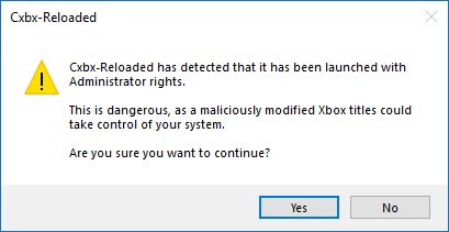

Has anyone been able to run cxbx reloaded as administrator in Hyperspin ?
Reason I ask is although i can run it ok in Windows 10 if I do not set Hyperspin to run as admin, many other systems then do not work (gameloader etc) without setting each game to run as admin
Even when i leave fade in off to allow myself to click yes in the confirmation box (see image) it still won't load.
It's annoying as this emulator is now working well on certain games. Most emulators have an option to turn stuff like this off but I can't find it if it exists.
Any help appreciated.
Note, CXBX RELOADED emulator itself is not set as admin, just Hyperspin and this brings up this error.

I had the same problem. Changed the module.
HyperSpin\RocketLauncher\Modules\Cxbx-Reloaded\Cxbx-Reloaded.ahk
