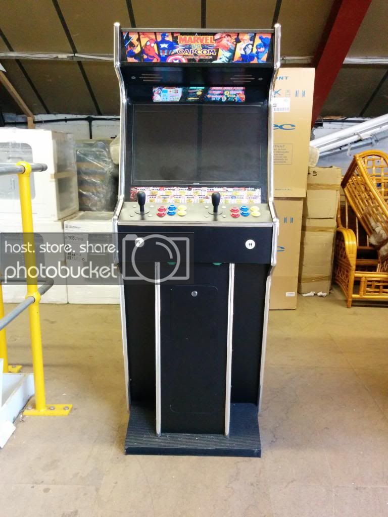

At the start of Jan me and my girl friend moved into a smaller flat so I put the arcade into storage. Well I have convinced her that we have space for it but before I bring it home I am doing a few small upgrades. Just thought I would share as I go along as this place has been quite lately.
Before I started.

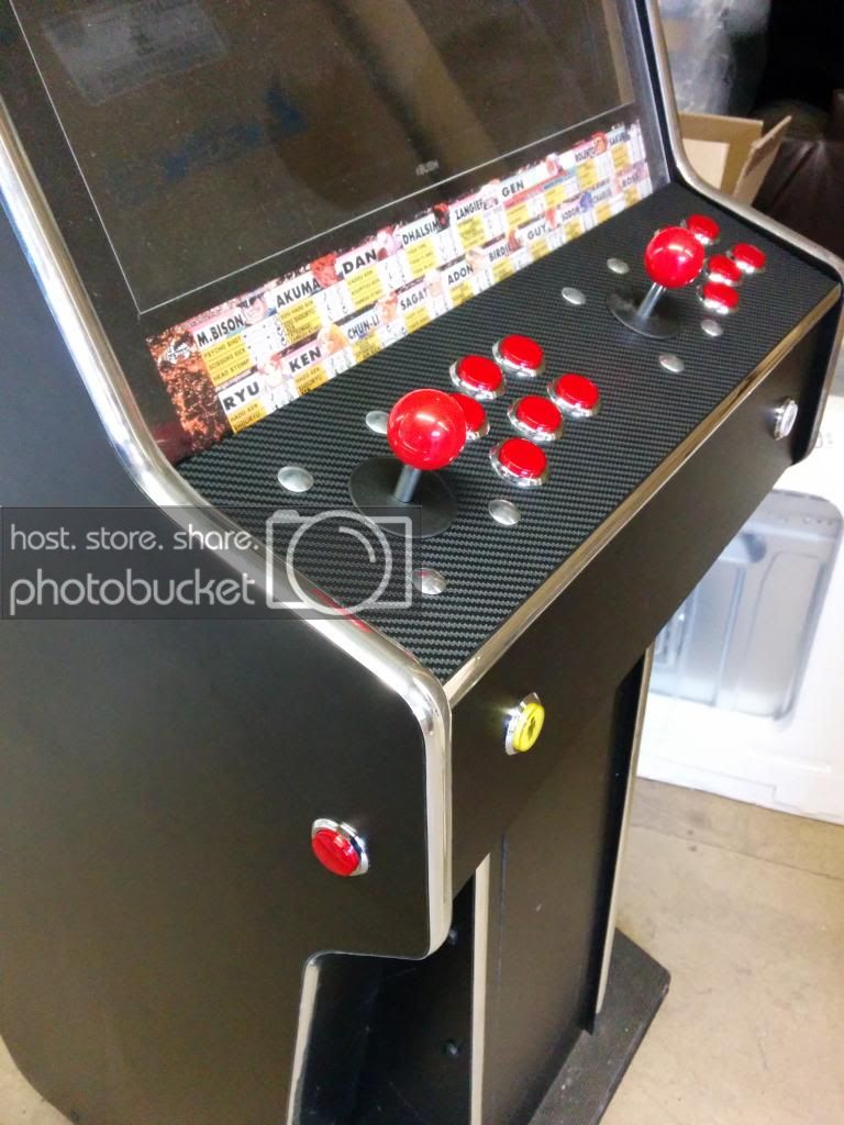

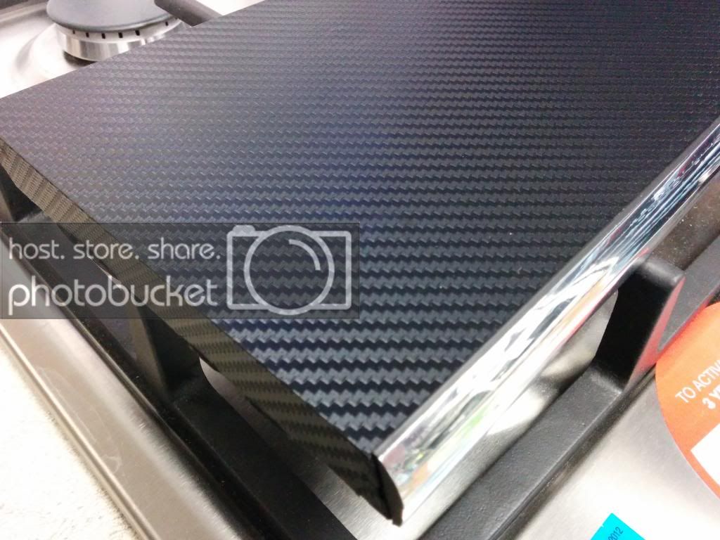

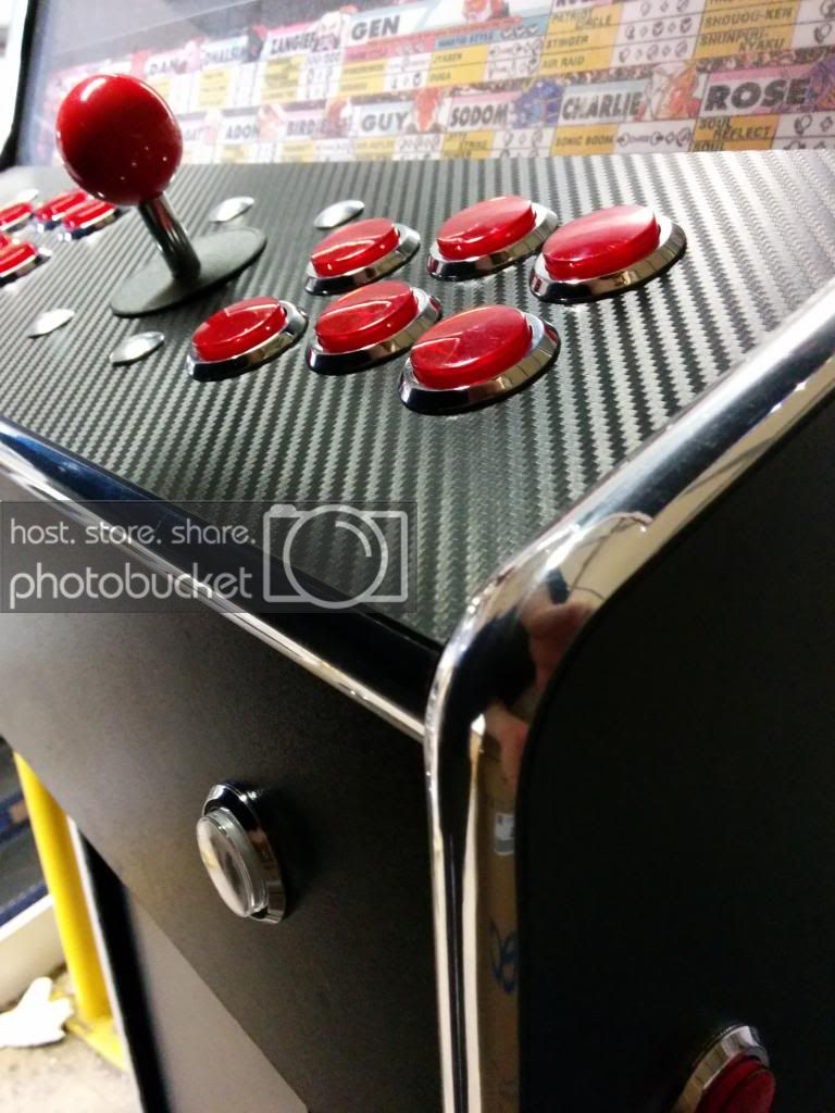

I started off by wrapping the CP in carbon fiber wrap.

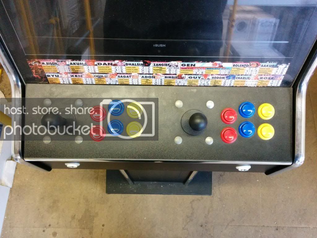

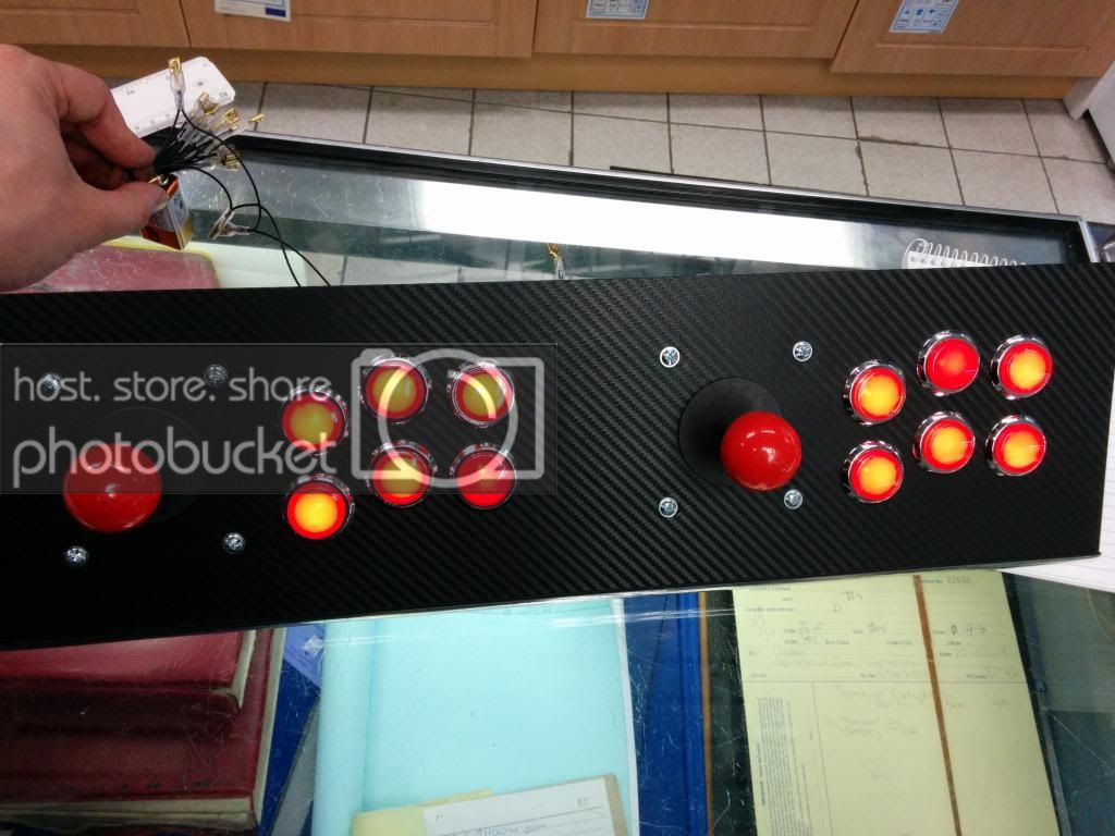

New illuminated buttons and new joysticks. I had major issues with the joysticks and mounting them. The old joysticks used a M6 Coach Boltand the new ones wanted an M4. So I ordered M4 Black coach bolts but of course they fell through the CP as the hole was meant for an M6. So i had to drill out the plates on the new joysticks and use the old bolts.... for now I have an idea for them later on.
Can you notice the Yellow button.... Whoops an ordering error. :@

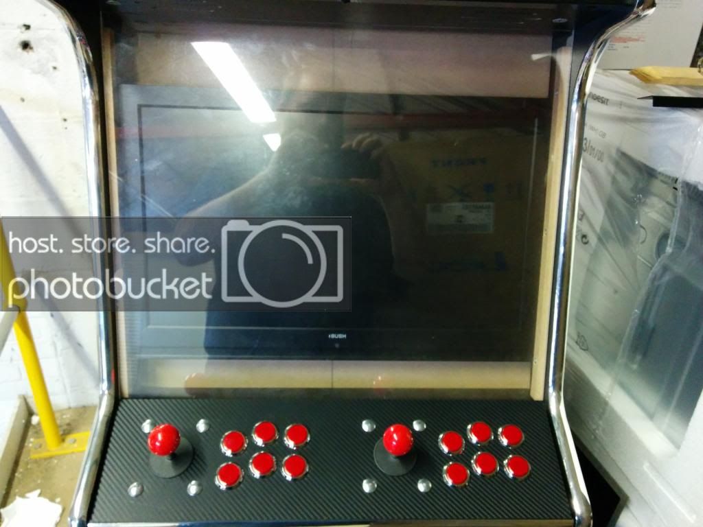

Next up was to get the screen 100% straight. With that being a little off and the old vinyl being VERY off it looked like the screen was installed by a man with one leg shorter than the other.
Still need to tidy the cables up and that horrid bit of MDF but its coming along.

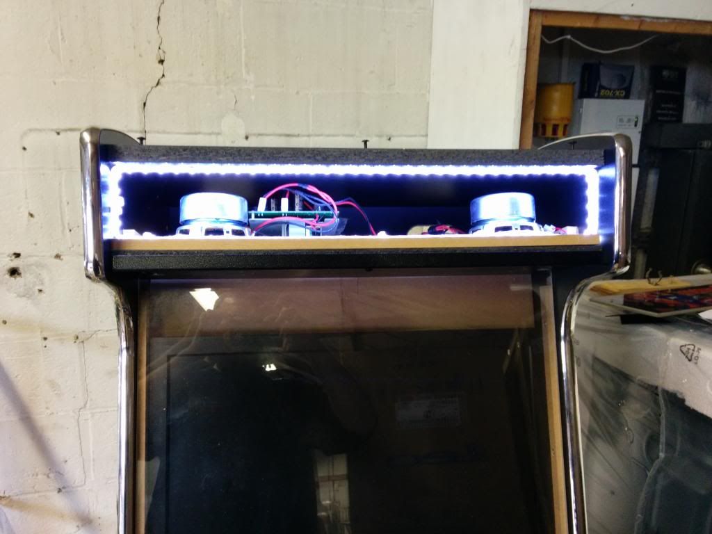

Today I removed the old Tube lighting system I had. It used to run very hot and I get worried... No heat now. :D

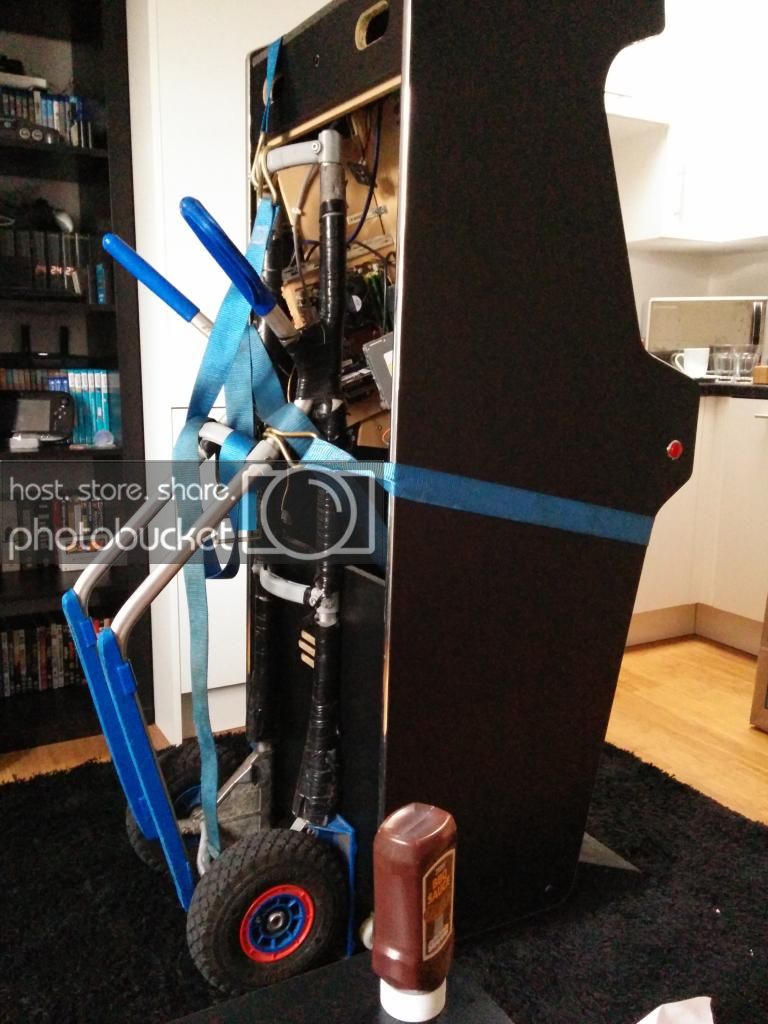

Well i got it home the past weekend and started work again. With the power of Tesco Value BBQ sauce I pulled the @8"ck~r up 2 flights of stairs.

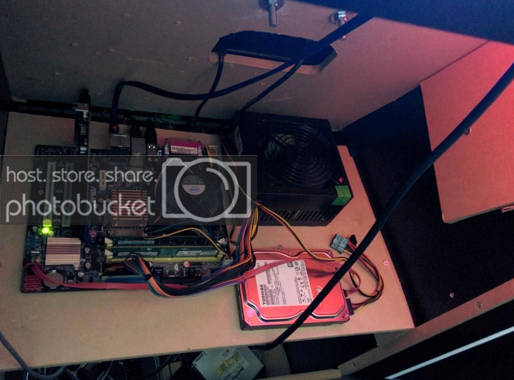

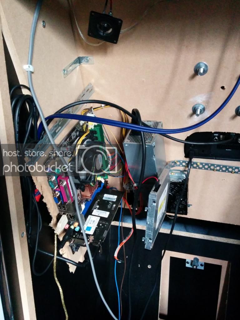

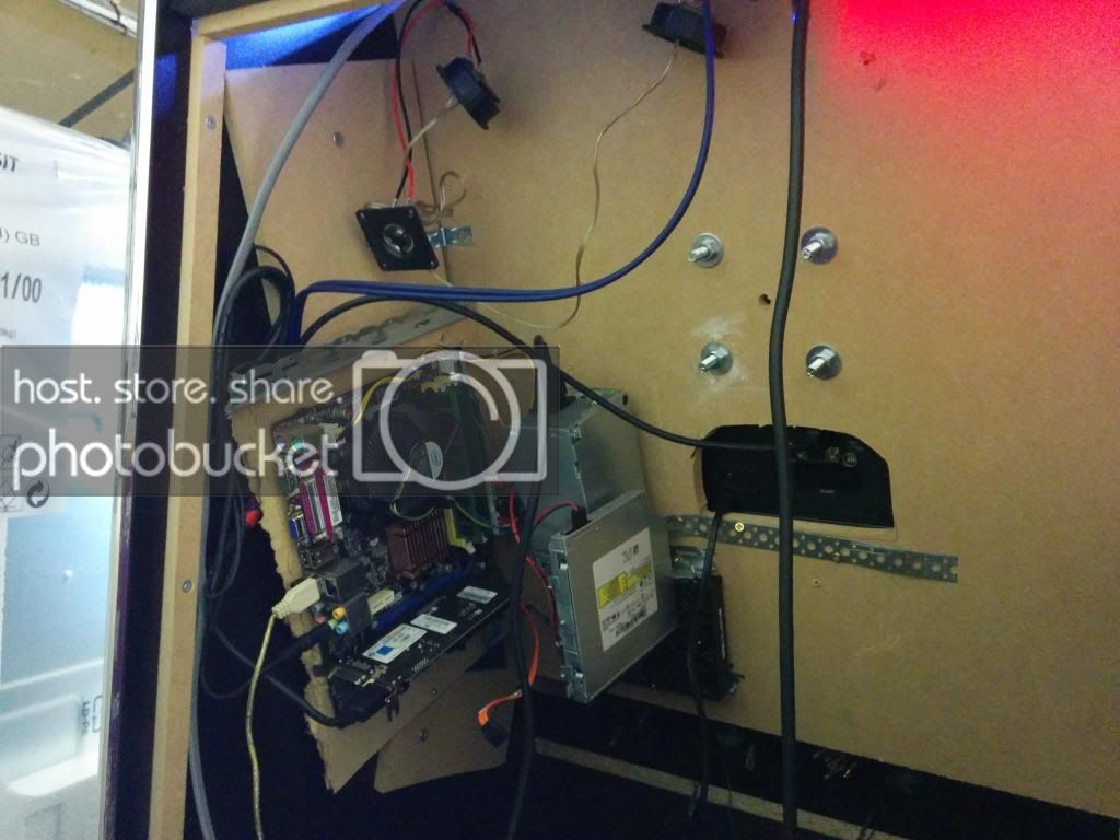

You may recall this heap of a mess stuck the inside of the cab. Today I knocked up a quick removable shelf so I can easily take the PC out if it ever needs work on it.
