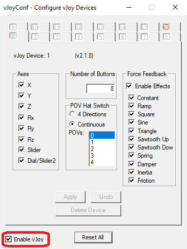

Once you have downloaded the file vJoySetup.exe, execute and install it with all the default options (do not change the installation path or uncheck / remove any option). This is very important for the following steps.

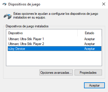

Next, in the search bar of Windows 7 / Windows 10, write “USB game devices” and press the “Enter” key. The following window will appear, showing you the game devices installed on the computer:
Now you will see a new device called “vJoy Device”, which was created when the driver was installed. Before proceeding, we must uninstall this device, since it will not be controlled by the Virtual Controller software, as it was created without said program. To eliminate it, within the Windows Start Menu, look for the direct access to the program “Configure vJoy.exe”, inside the "vJoystick" access folder, and execute it. It should open the following window:
where you must uncheck the box “Enable vJoy”. With this you are erasing the virtual device created when you installed the driver.

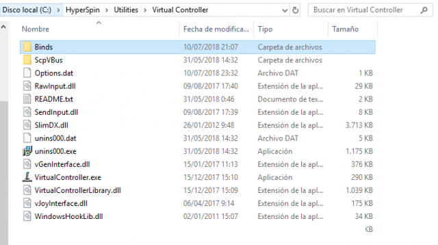

Now you can proceed to install the Virtual Controller program. Download the installer from the developer's website:
Virtual Controller download: https://sourceforge.net/projects/vjoy-controller/?source=directory
Once the file is downloaded, execute it and install the program in its default folder or wherever you want. In the example the installation folder is:
C:\HyperSpin\Utilities\Virtual Controller\
This folder will remain like this:

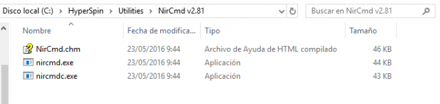

3.3-Installation of NirCmd
In addition to the Virtual Controller program, for its correct integration within HyperSpin with RocketLauncher, you will need the assistance of a small utility called NirCmd. You can download the latest version from its website or from the direct link:
NirCmd web page: http://www.nirsoft.net/utils/nircmd.html
NirCmd v2.81 32-bit direct download: http://www.nirsoft.net/utils/nircmd.zip
NirCmd v2.81 64-bit direct download: http://www.nirsoft.net/utils/nircmd-x64.zip
Once downloaded, open the ZIP file and decompress its content inside the folder:
C:\HyperSpin\Utilities\NirCmd v2.81\
You can change the name and / or the route at your whim. With this you already have NirCmd installed in your system. Here a snapshot of the installation folder:

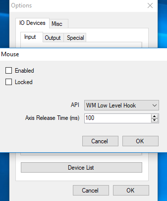

Mouse: As with the keyboard, it can be enabled / disabled and locked / unlocked.

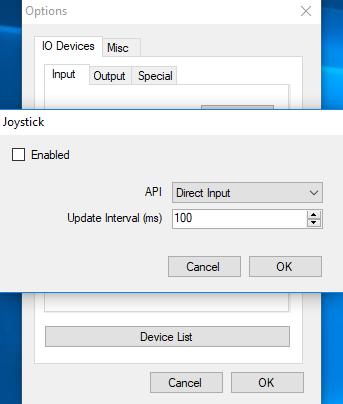

Joystick: It can only be enabled / disabled.

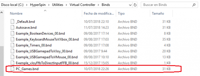

4.3-Controls

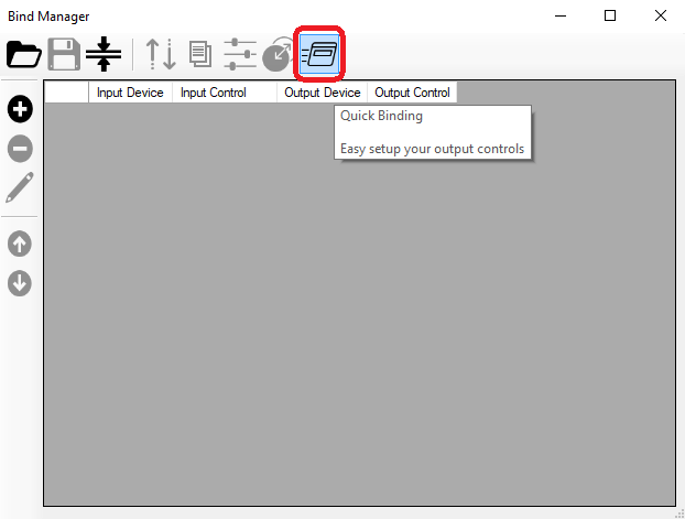

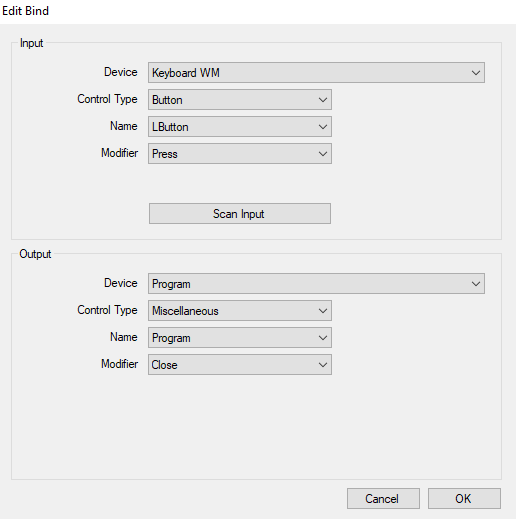

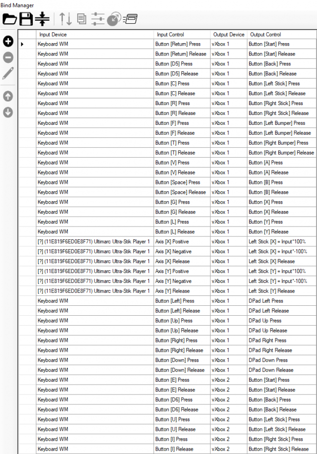

Clicking on the "Controls" button will open the window Bind Manager, where you can achieve the assignments from the input devices to the virtual output devices. At the end you can save the profile, always inside the "Binds" folder. It is important to point out that all the devices to be mapped will do so within a single profile. That is, unlike Xpadder, there is no profile for each input device, but only one for them all.

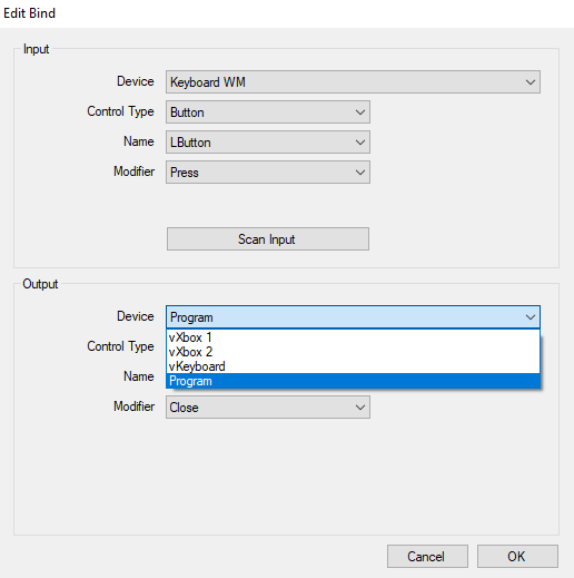

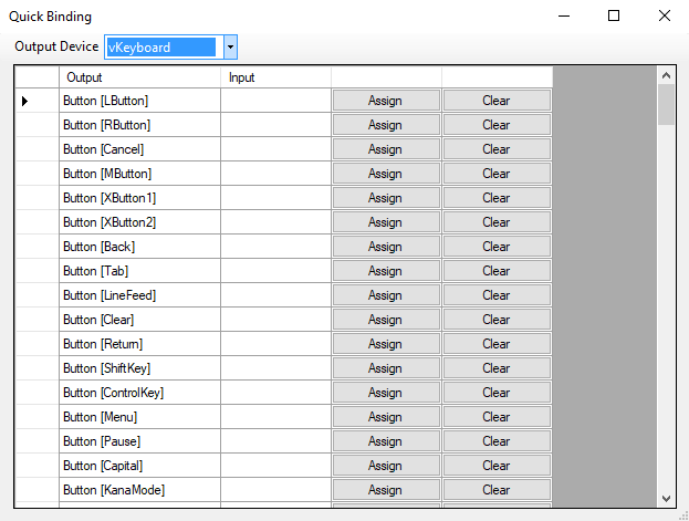

To perform a quick assignment it is best to click on the "Quick Binding" button, which will open the following window:

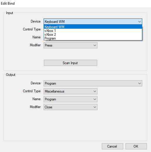

You will find a drop-down called "Output Device", where you can select the virtual devices to which you want to make the assignments. Once you finish and close this window, it will return to the previous one (Bind Manager).
If you made a mistake when making an assignment, or want to edit it, it is as simple as marking it with the mouse and clicking on the edit button. You have many options, not only to assign keys and buttons, but also program actions:

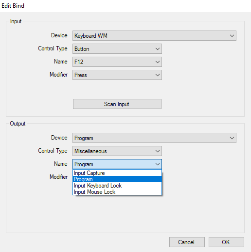

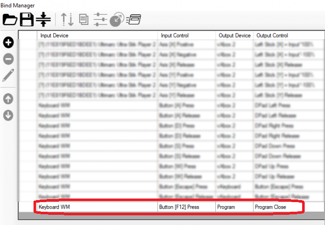

If you have activated the keyboard lock in section 4.2.1.1-Input ---> Keyboard ---> Lock and if you have not assigned a key in the profile to allow the keyboard unlock, the following informative picture will appear at activating the controls profile:
This message is a warning about the possibility to get the keyboard permanently blocked and loose control.
To avoid this error message you must add at least one assignment to allow unlocking the keyboard. For example:

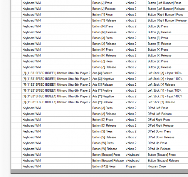

Keyboard [Button] [Esc] [Press] => Program [Close]   ---------------->   Where the "Esc" key closes the program (unlocking the keyboard)
o
Keyboard [Button] [Esc] [Press] => Program [Keyboard Lock] Off   --->   Where the "Esc" key unlocks the keyboard
It is important to avoid the appearance of the information box for the integration of Virtual Controller in HyperSpin with RocketLauncher, since it will break the script. In the example the F12 key (or the key you prefer) is assigned to close the program when leaving the games:
Keyboard [Button] [F12] [Press] => Program [Close]
You can configure the rest of assignments to your liking, but do not forget to make an assignment to close the program.

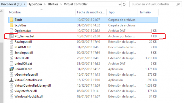

Now, inside the Virtual Controller folder create a .BAT file to load the profile already created. You can name this .BAT whatever you want, but in the example it is PC_Games.bat:
If you do not know how to do it, create a blank .TXT file and write the following text:
@echo off
CLS
start VirtualController.exe /loadcontrols PC_Games.bnd /capture /minimized
CLS
Exit
Save and change the name of the file and the extension. It will look like this:
When this file is executed the virtual devices are created and the Virtual Controller profile is loaded.

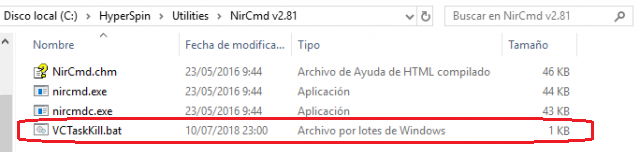

Next step is to create another .BAT file in the folder where NirCmd is installed. This .BAT file will be used when to close Virtual Controller when leaving a game. In the example it is named VCTaskKill.bat[/ b]:
The content of the file should be as follows:
@echo off
CLS
nircmd.exe sendkey f12 press
CLS
Exit
That is, it will look like this:
When this file is executed the F12 key is pressed, closing the Virtual Controller program and uninstalling all the virtual devices.

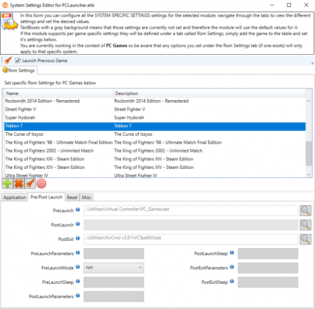

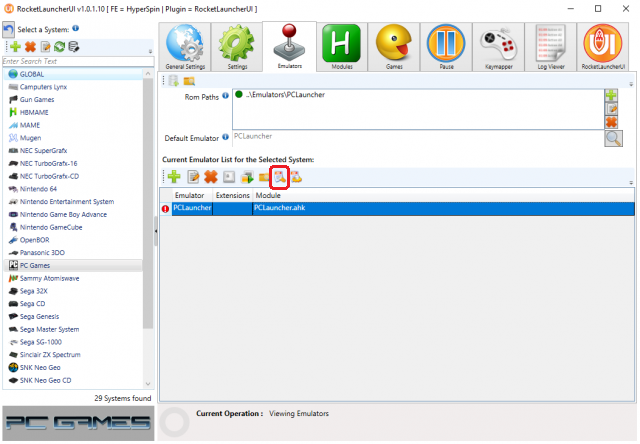

Now let's call these files from "RocketLauncherUI". Open the program and within its interface select the "PC Games" system. Inside it press the tab "Emulators". Then mark the emulator line "PCLauncher / PCLauncher.ahk[/ u]" and click with the left mouse button on the global options icon of the emulator:
The following window will open, where you will have to mark the game with which you want to use the "Virtual Controller" profile created before. In the example I'm doing it with the game Tekken 7:
In the "Pre / Post Launch" tab it must be entered the location of each of the .BAT files previously created:
 - In Pre Launch[/ u] it must be introduced the location of the file PC_Games.bat[/ b], in the example: C:\HyperSpin\Utilities\Virtual Controller\PC_Games.bat
 - In Post Launch it must be introduced the location of the file VCTaskKill.bat, in the example: C:\HyperSpin\Utilities\NirCmd v2.81\VCTaskKill.bat
With this ends the integration of the profile in the game Tekken 7. To do it with any other PC game you should only repeat the process. You may use the same Virtual Controller profile for all the PC games that need it, that's why it has been called PC_Games.
