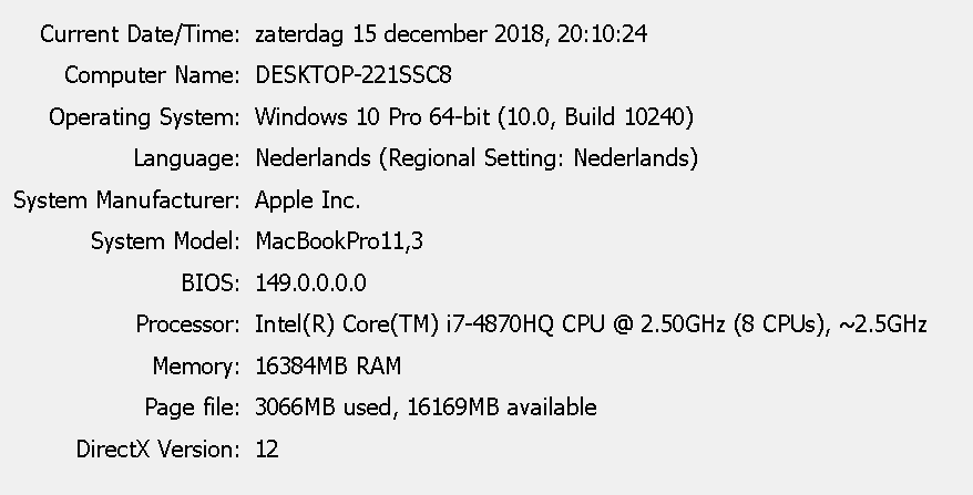

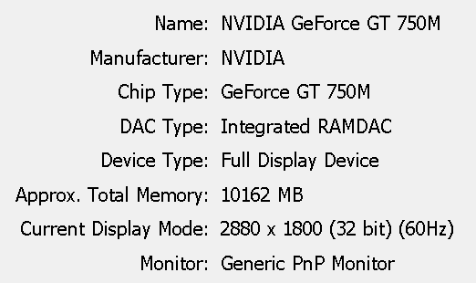

This is my system:
The second graphics card Apple iris something is not recognized by WINDOWS, but that shouldn't be a problem.
I really hope someone can help me get into this.
Also, what do you think about my Laptop, is it strong enough to be a neat emulation machine?
