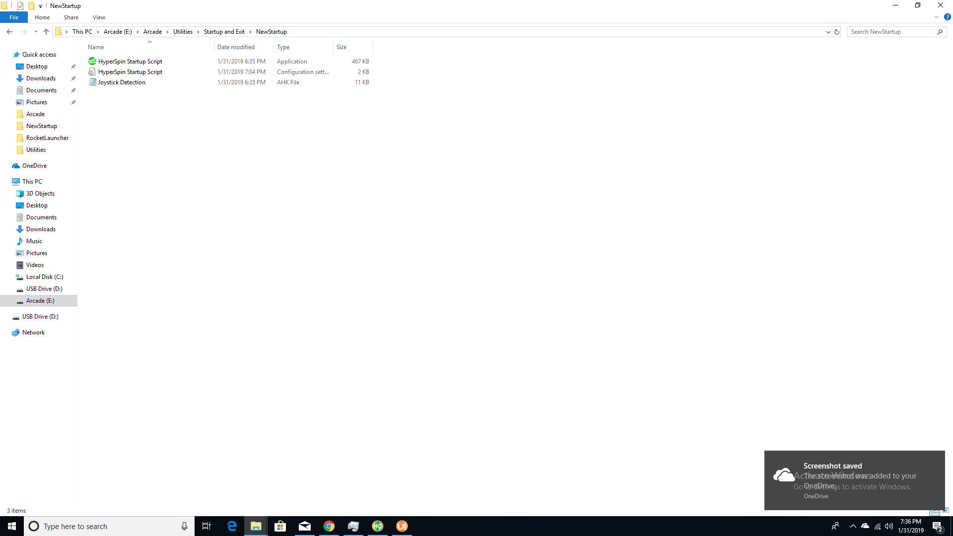

Here are some screen shots.  I think I am doing what you told me to do but to no avail. please look at these and see if you can spot any errors.

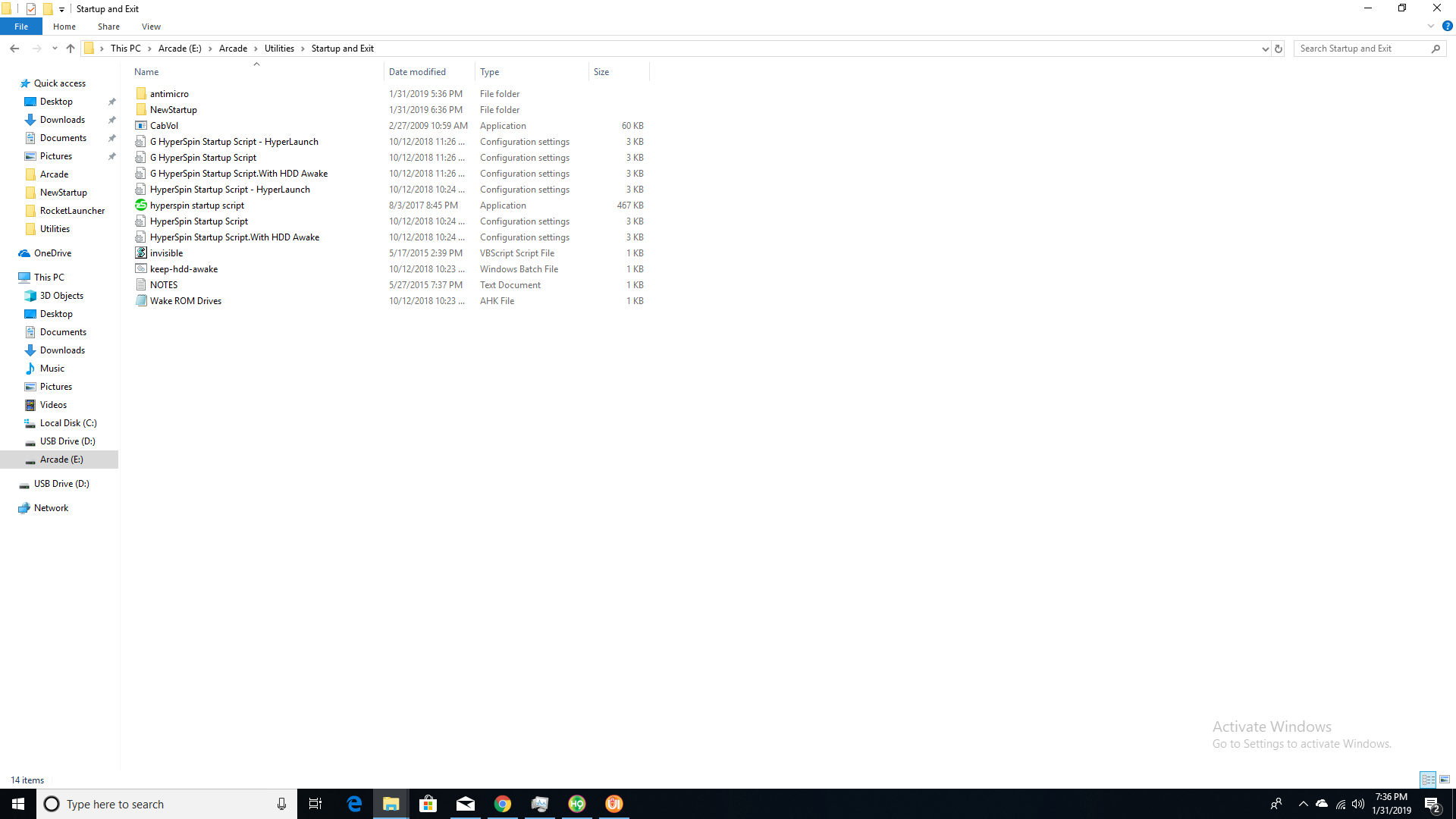

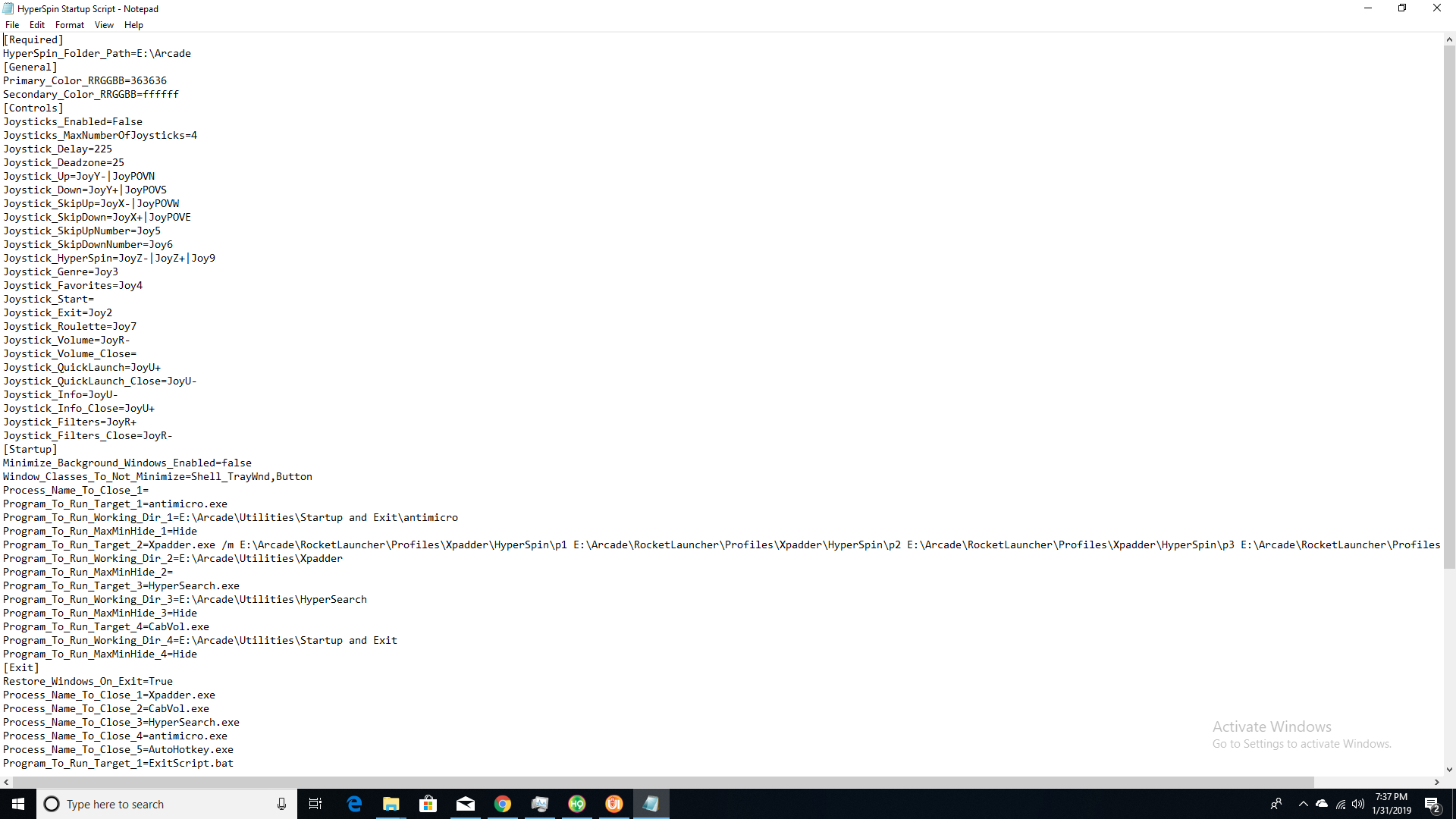

The start up you sent me is under NewStarup and pathed correctly i think....   The last shot is of the script that the Hyperspin came with... Should I delete that?

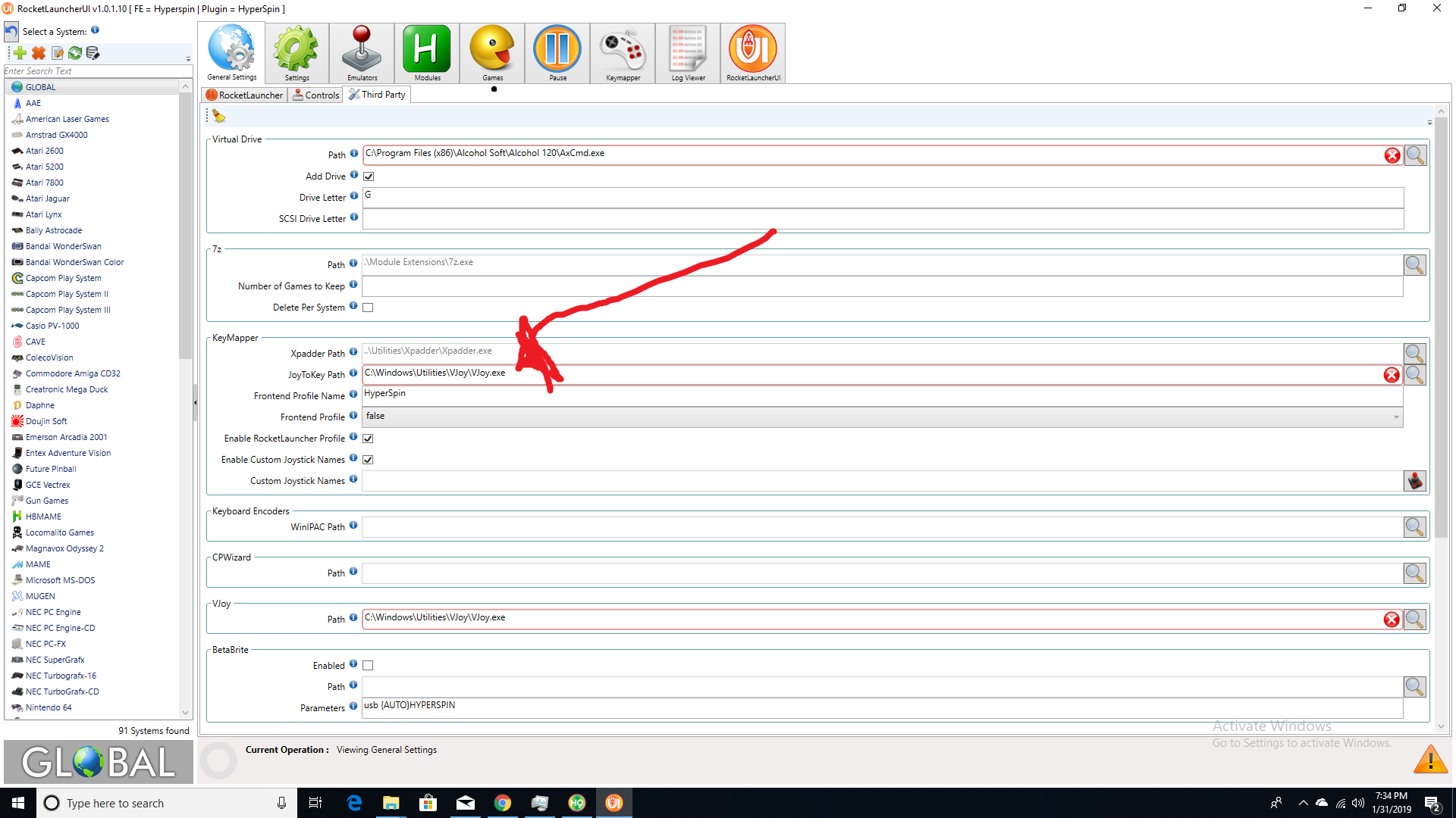

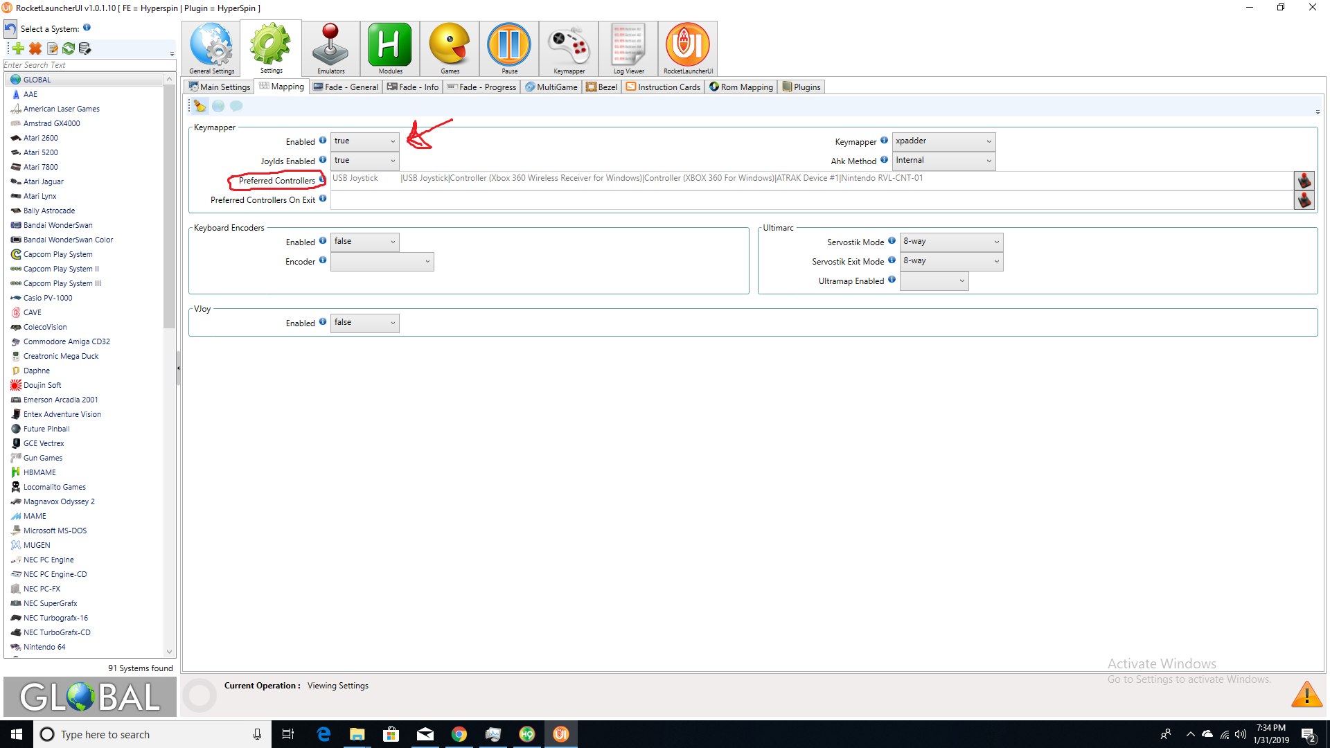

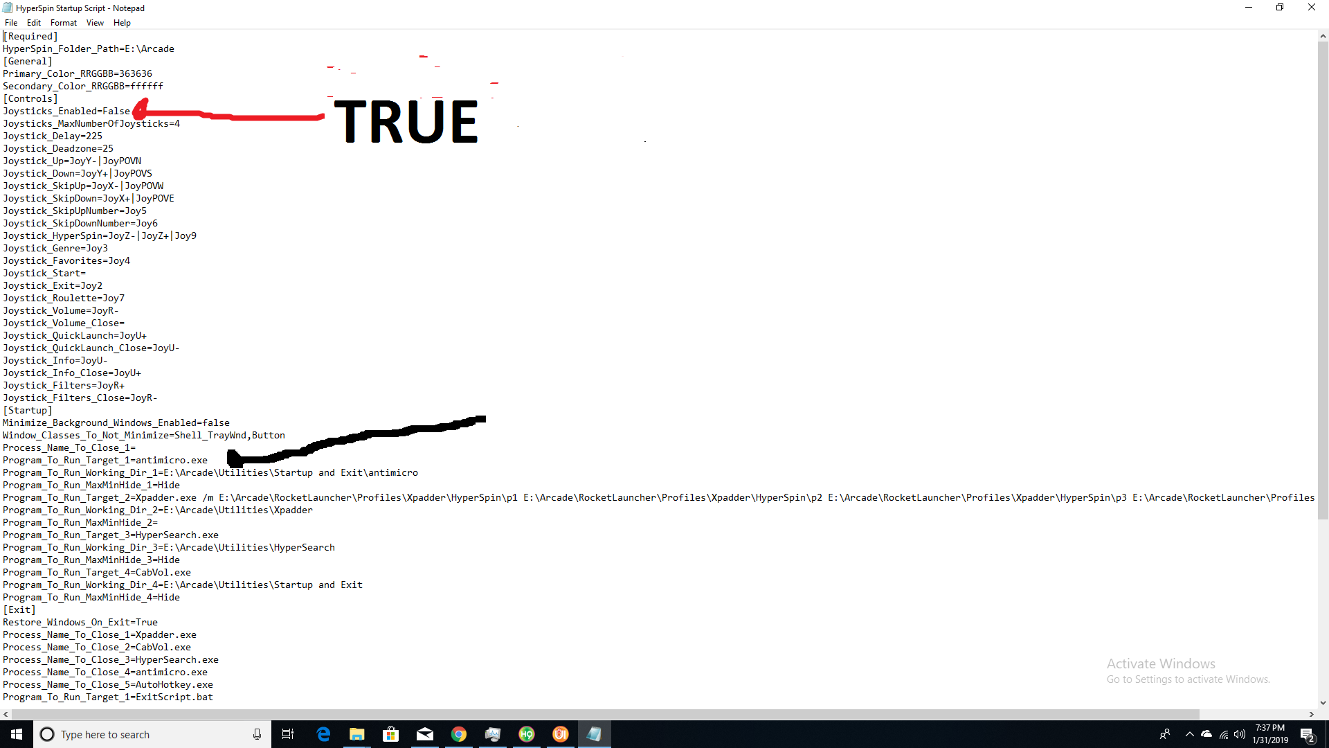

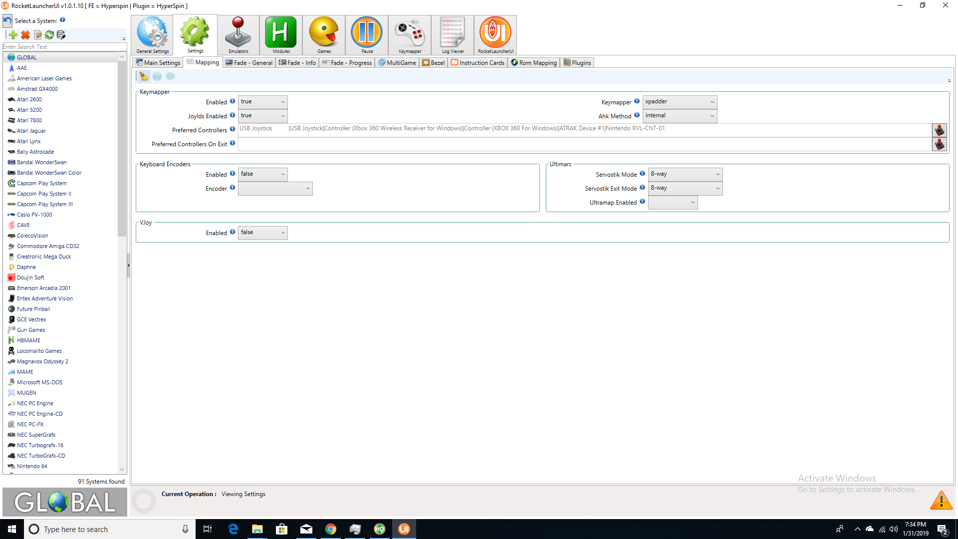

the path to your joytokey is not correct thats why you have a red circle next to it

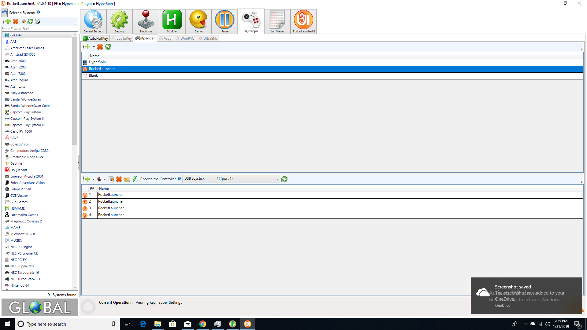

not that it matters given that your system is set up to use Xpadder1.png.85e062b0c9f65ded7411f86e0bde659a.png
if you are going to use the start of script you need to disable Xpadder

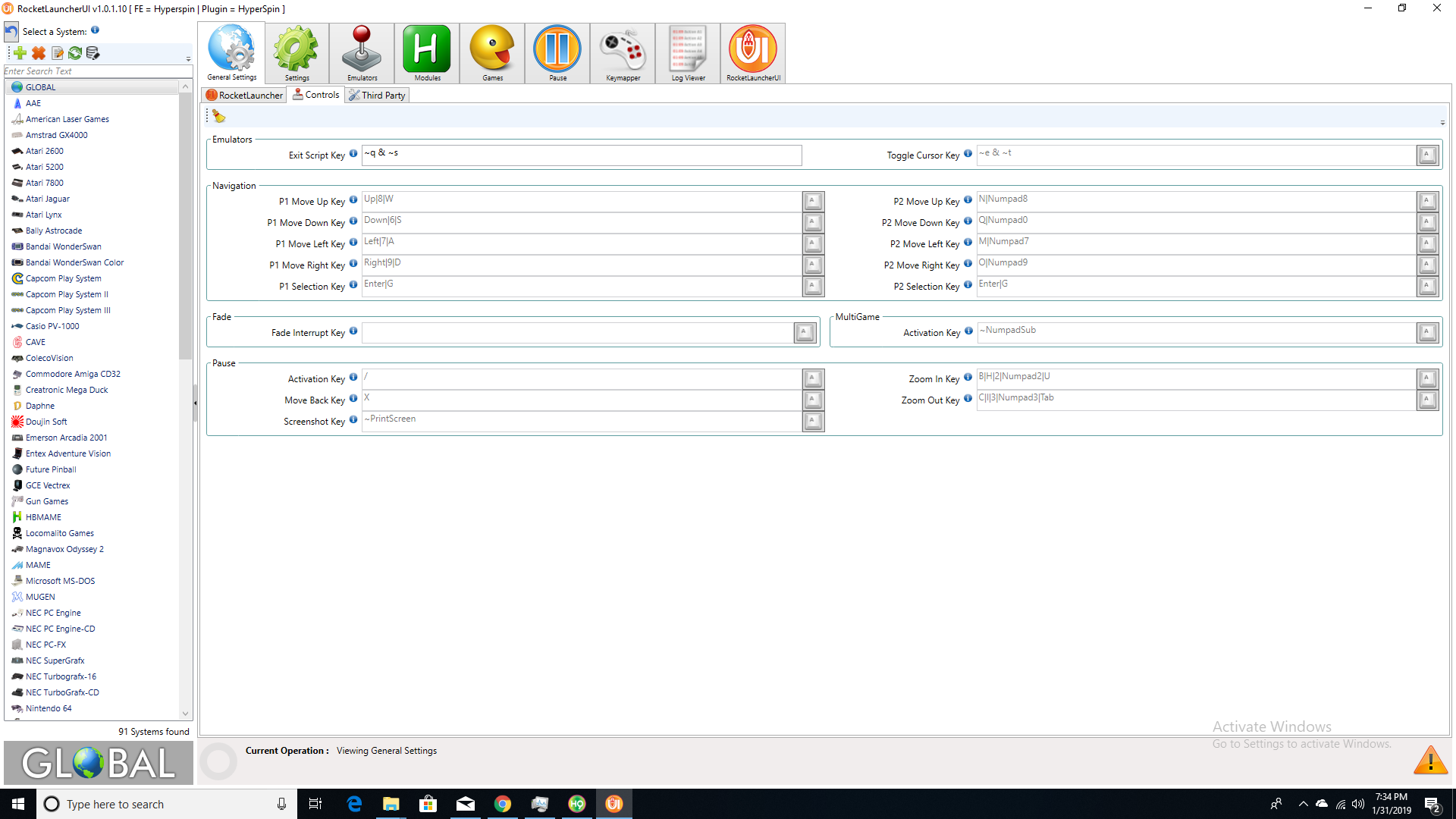

Rocektlauncher will set IDs to each controller if you currently have a Preferred controller,  if you are not using an Xbox controller this might be an issue
if you are using anything else change this to your controllers
this is for loading specific profiles for specific controllers,  if you disable the key mapper it will not be a problem
unless you have your own INI with multiple batch start up programs

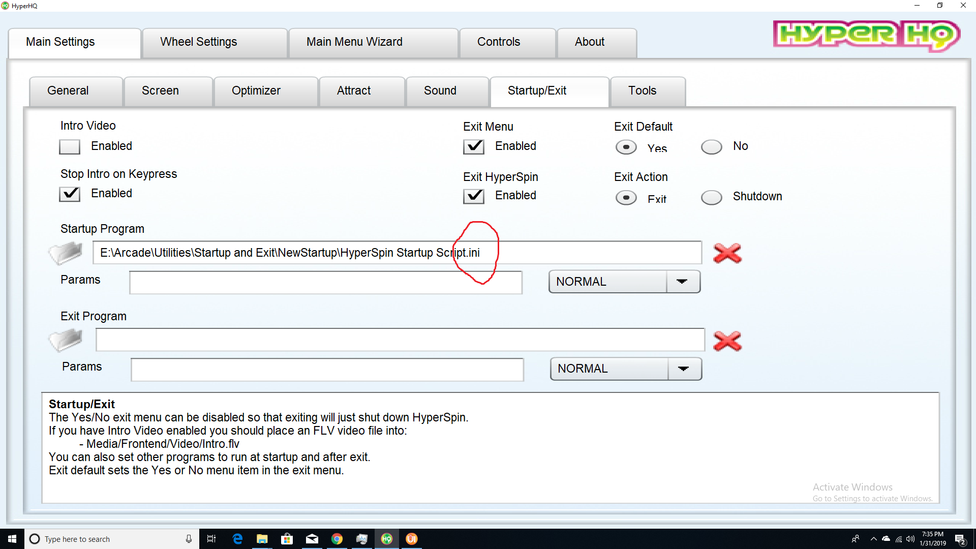

this should point to the exe not the INI (see my picture above)
your start up script is not currently enabled
you also have Xpadder profiles being closed  along with another Mapper  Antimicro.exe.
all this programs need to go away if they have Hyperspin controller profiles or they will interfere with the Start Up Script
forgot to mention this but
your INI does not have a button mapped to start
Joystick_Start=
you need to change all this to match the buttons on your controller

Ok For some reason Hyperspin still will not recognize my emulators....  Here is the start up script that is running. can you see anything that is keeping Hyperspin from finding my joysticks and buttons?
Windows see the joysticks and buttons and they test fine ... but nothing when I launch Hyperspin.  Can you think of any other screen shots I need to send you?

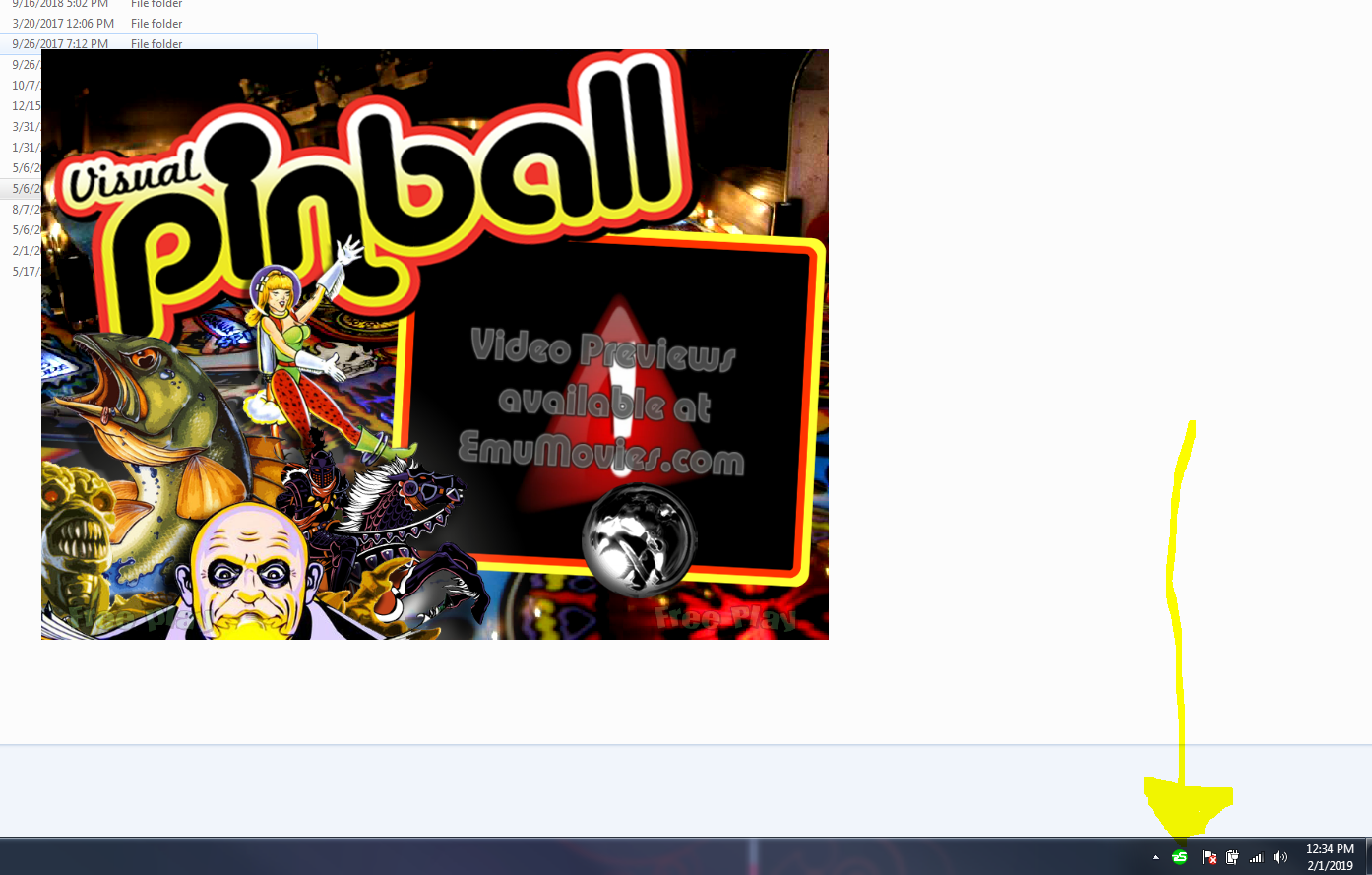

the only thing I can think of is to make sure that the start up script exe is actually running when you launch Hyperspin
launch Hyperspin in window mode
go to your task bar and see if you find the start up script exe running
or do an ctrl+alt+delete to bring up your process Task manager.
Hyperspin Start Up Script.exe should be running when Hyperspin.exe is running
and it should close when you exit hyperspin.

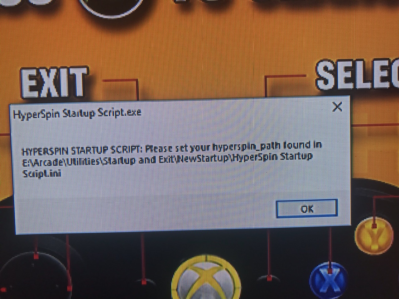

Am keep getting this message when i have the path set to INI, and it does appear that the start up script is not running in the when i check task manager.  What are your thoughts?
YAY!  I can navigate Hyperspin now!  OK so now what is the next step in mapping the the emulators to the systems?  I used the tab function but it only wants to see the keyboard as player 1.  i changed the max number of joysticks to 6 so now all 4 joys can work hyperspin.  thank you so much we are getting close!

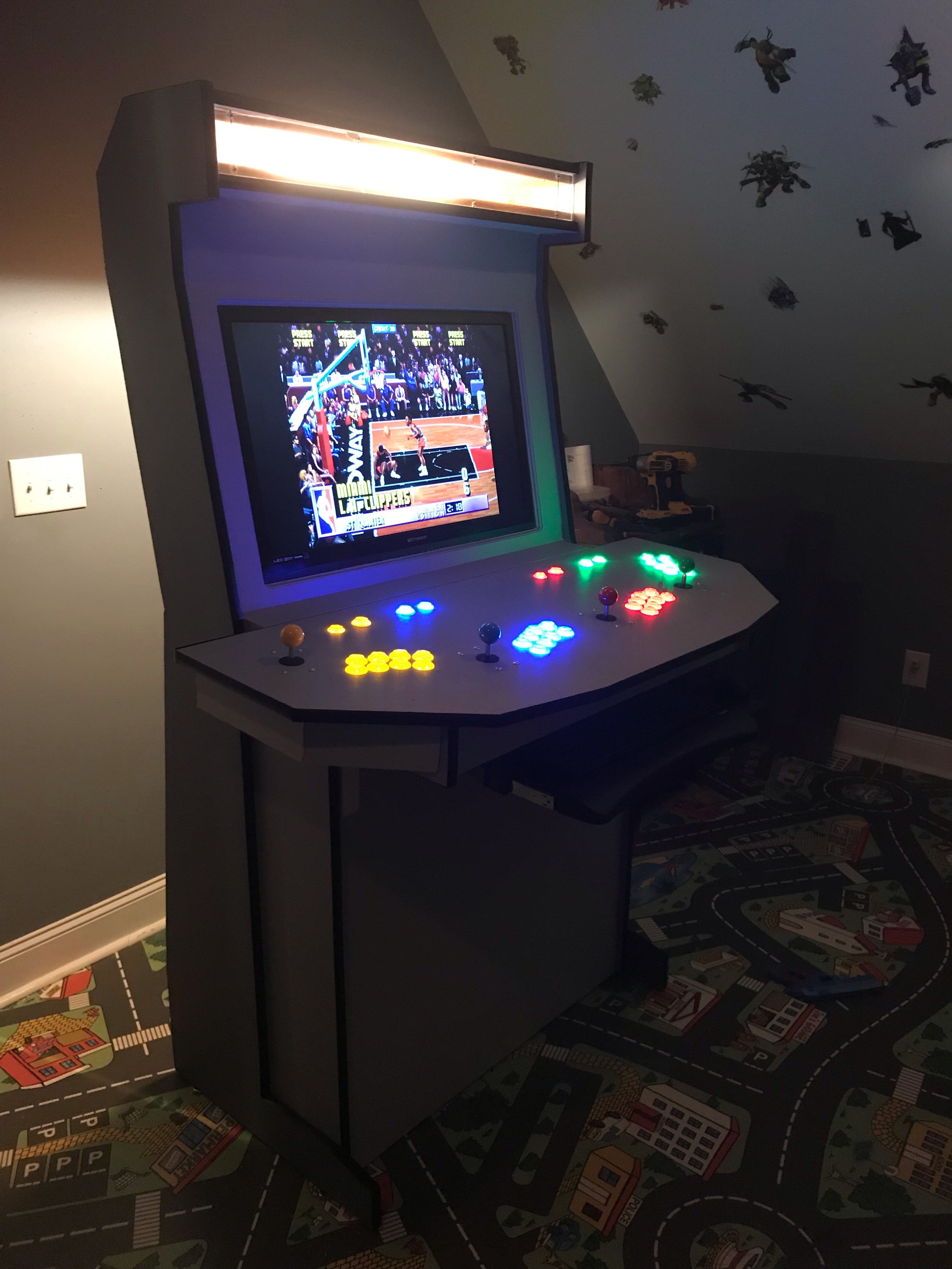

OK!  I need a bit more help/advise please.   Systems like MUGEN and a few others will load and games will load up for play but I cant map the joy sticks.  The Keyboard can operate the games but my normal push the tab key and map the game doesn't work....  Any thoughts on this?  Is this a script issue?  Here is what the cabinet looks like just got the marquee ordered!  Again all your help is very appreciated!
