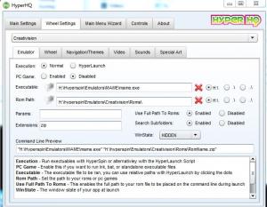

Yourname942 Posted June 6, 2014 Posted June 6, 2014 2 questions: Does anyone know why Hyerspin freezes (its almost like it launches the game and keypresses don't do anything in the hyperspin menu until I alt tab out and back) Does anyone know how to get Creativision to work using mame? Thank you.

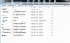

Yourname942 Posted June 6, 2014 Author Posted June 6, 2014 I added rom in the extensions but it still has the same issues. (doesn't launch games, and when I try to launch a game from the hyperspin game list the buttons stop functioning (can't press esc to go back/etc until I alt tab out and back into hyperspin)

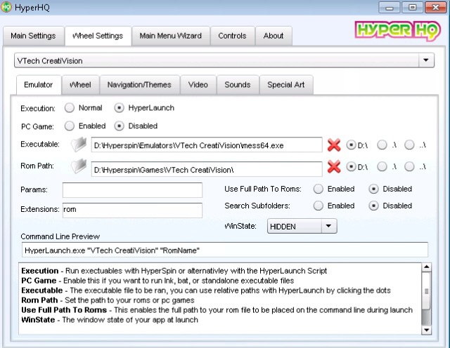

yashijoe Posted June 6, 2014 Posted June 6, 2014 Hi yourname942, first change rom extension from "zip" to "rom", as your games are not zipped. I use mess for this system, no idea if mame works.
Yourname942 Posted June 6, 2014 Author Posted June 6, 2014 yashijoe said: Hi yourname942,first change rom extension from "zip" to "rom", as your games are not zipped. I use mess for this system, no idea if mame works. I did that, but the issues are still there..
yashijoe Posted June 6, 2014 Posted June 6, 2014 Yourname942 said: I did that, but the issues are still there.. Have you tried with mess instead of mame? MESS any way is based on the MAME core, but emulates many other consoles.
yashijoe Posted June 6, 2014 Posted June 6, 2014 Also set "execution" "use full path to roms" "search subfolders" as in my pic.
yashijoe Posted June 6, 2014 Posted June 6, 2014 As bios you can just keep the file crvision.zip and delete the other 3 files. Mess can handle zip games/bios.
