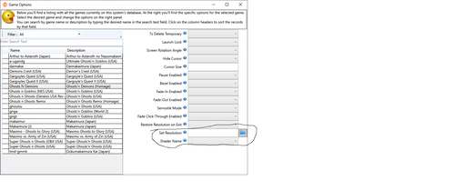

mikea213 Posted November 20, 2019 Posted November 20, 2019 did you try to change it here? If you set it all up just in mame and it works but when you run RL it stops you can change it here to whats below or lock the MAME.ini file so it doesnt default to the lower.
KTMSPARK Posted November 20, 2019 Author Posted November 20, 2019 Hi Mike , Yes i tried to force resolution there to test on a per game basis , but even changing that did not work unfortunately
