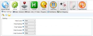

DrMaxwell Posted June 14, 2014 Posted June 14, 2014 You might need to be specific about how it "jumps outside of HyperSpin and runs on the PC". 1. It could be that you haven't set the HyperLaunchHQ settings correctly to hide certain application layers: 2. When MAME is selected does it go into the games wheel screen where you can select what you want to play? If not then your paths are not correctly set. If there is a problem with HyperLaunch or Hyperspin, then you have error logging features to track that inbuilt; however, it appears from what you've said that it is launching the program separately. In either case more information about your HyperLaunchHQ settings and operating system is needed. Windows 7 and 8 UAC sometimes restrict programs loading as intended and you might need to run them in compatibility mode depending on your setup. How to guides and custom artwork sets @ https://www.youtube.com/user/MaxwellParadigm Themes, Wheels, Carts and Database Downloads available @ http://spacevalkyrie.weebly.com/

ArcadeBliss Posted April 3, 2015 Posted April 3, 2015 I was having a simular problem where after selecting a game, just before the fade screen would start, Hyperspin would move to the next game on the menu. This caused Hyperspin to still be running even though the emulator ran fine after the fade screen. After much trail and error I found the problem. - Hyperspin was configured to use a spinner (or mouse doesn't matter) - RocketLauncher was configured to "Hide the Cursor" What was happening is that before starting the fade screen, HyperLaunch moved the mouse cursor off screen and this triggered Hyperspin to move one game. Because of the speed of HyperLaunch, HyperSpin did not recognize that it has lost focus. The easy solution was - Configure HyperLaunch not to hide the cursor. A permanent solution would involve Hyperlaunch to hide the cursor after the fade screen or emulator has started. Hope this helps others with this problem. Cheers.
