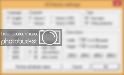

craiganderson Posted June 16, 2014 Author Posted June 16, 2014 yes. But all relayed systems like msx msx2 msx2+ etc. here is a picture of the settings popup from within the emulator see under "computer" there are four choices each game only works with one of those choices (of all related systems (like msx msx2 msx2+)) does not accept command line so using clickcontrol to click different choices/system for different games thank you very much for ur time and expertise Sent from my Droid Mini. http://craigandersonthemes.weebly.com/
bleasby Posted June 16, 2014 Posted June 16, 2014 If you want to use them as a single system I would follow the suggestion that I gave to you on the first post. Editing your module I would do something like this: yMEmu = DCHector MEmuV = v0.1 MURL = http://dchector.free.fr/index.html#top MAuthor = craiganderson MVersion =1.1 MCRC = iCRC = MID = MSystem = "Hector HRX" ;---------------------------------------------------------------------------- ; Notes: ; This module uses a BlockInput command which on my computer requires hyperspin and xpadder to be run as administrator. ; If Emulator Language is French and you would like English: Go to Options>Paramatres and Click "Anglais". ; In Emulator, go to Options>Settings: Click "Fast input" under Tape. Seems like a good idea to me. Has not caused a problem on my system yet. ; To Setup Keyboard/Joysticks: In Emulator, go to Options>Keyboard. But...Fyi....The DEFAULT joystick input is as follows (all on number pad): ;...........................Player 1..........Player 2 ; Up........................Num5............Num/ ; Down...................Num2............Num8 ; Left.....................Num1.............Num7 ; Right...................Num3.............Num9 ; Button.................NumEnter......Num+ ; Set fullscreen mode in Global Module Settings in HLHQ (and fullscreen equals maximized window because fullscreen emulator seems to act odd). ; Roms must be named exactly as they are referred to in module. This is because there are four ways (i.e. four systems) to load different roms and the module assigns the rom to the right loading process based upon its full name. ;---------------------------------------------------------------------------- StartModule() FadeInStart() 7z(romPath, romName, romExtension, 7zExtractPath) settingsFile := modulePath . "\" . moduleName . ".ini" micronComputer := IniReadCheck(settingsFile, "Settings|" . dbName, "Micron_Computer","Hector1",,1) ;Hector1, Interact, Hector2HRp, Hector2HRX Fullscreen := IniReadCheck(settingsFile, "Settings", "Fullscreen","true",,1) SetKeyDelay, 200 BlockInput, On Run(executable, emuPath) WinWait(" DCHector - Micronique Hector emulator ahk_class Hector") WinWaitActive(" DCHector - Micronique Hector emulator ahk_class Hector") Sleep, 100 WinMenuSelectItem, ahk_class Hector, , Options, Settings WinWait(" DCHector settings ahk_class #32770") WinWaitActive(" DCHector settings ahk_class #32770") Sleep,2000 if (micronComputer="Interact") CurrentButtom := "Button6" else if (micronComputer="Hector2HRp") CurrentButtom := "Button7" else if (micronComputer="Hector2HRX") CurrentButtom := "Button8" else ;micronComputer="Hector1" CurrentButtom := "Button5" Loop, 3 { ControlClick, %CurrentButtom%, DCHector settings Sleep,500 } Loop, 25 { ControlClick, %CurrentButtom%, DCHector settings Sleep,10 } Sleep, 1000 Loop,5 { IfWinExist, DCHector settings ahk_class #32770 { Sleep, 100 ControlSend, Button31, {Enter}, DCHector settings ahk_class #32770 } } Sleep,500 Loop,5 { IfWinExist, DCHector Setting modification ahk_class #32770 { Sleep, 100 ControlSend, Button1, {Enter}, DCHector Setting modification ahk_class #32770 } } Sleep, 500 WinWait(" DCHector - Micronique Hector emulator ahk_class Hector") WinWaitActive(" DCHector - Micronique Hector emulator ahk_class Hector") WinActivate, DCHector - Micronique Hector emulator ahk_class Hector Sleep,1000 WinMenuSelectItem, ahk_class Hector, , File, Load Tape Sleep,3000 Loop { ControlGetText, edit1Text, Edit1, Open ahk_class #32770 If ( edit1Text = romPath . "\" . romName . romExtension ) Break Sleep, 200 ControlSetText, Edit1, %romPath%\%romName%%romExtension%, Open ahk_class #32770 } Sleep, 3000 Loop,5 { IfWinExist, Open ahk_class #32770 { Sleep, 100 ControlSend, Button1, {Enter}, Open ahk_class #32770 } } Sleep, 4000 SetKeyDelay, 50 if (micronComputer="Hector2HRX"){ Send {2 down} Sleep,1225 Send {2 up} } else { Send {l down} Sleep,1225 Send {l up} } If Fullscreen = true { Sleep,1250 SetKeyDelay, 50 ;Send, {ALT down}{ENTER down}{ALT UP}{ENTER UP} WinMaximize, DCHector - Micronique Hector emulator ahk_class Hector } Sleep, 500 BlockInput, Off FadeInExit() Process("WaitClose", executable) 7zCleanUp() FadeOutExit() ExitModule() CloseProcess: FadeOutStart() Process, Close, dchector.exe Return and include on the same folder this ini file with the filename equal to your module name: [addemup_interact] Micron_Computer=Interact [attro_logic_interact] Micron_Computer=Interact [backgammon_interact] Micron_Computer=Interact [blackjack_interact] Micron_Computer=Interact [hangman_interact] Micron_Computer=Interact [knockdown_interact] Micron_Computer=Interact [stramble_hr] Micron_Computer=Hector2HRp [jeep-lunaire_hr] Micron_Computer=Hector2HRp [chenille_hr] Micron_Computer=Hector2HRp [pengo_hrx] Micron_Computer=Hector2HRX [hep-taxi_hrx] Micron_Computer=Hector2HRX #no need for settings games that follows the default micron computer Hector1: addition_hector1, asteroides_hector1, base_spatiale_hector1, chatbyrinthe_hector1, combat_hector1, cow-boys_hector1, crazy8_hector1, credits-avec-imprimante_hector1,credits-sans-imprimante_hector1, dogfight_hector1, encerclement_hector1, envahisseurs_hector1, flipper_hector1, formule1_hector1, galaxius_hector1, goofygolf_hector1, grenouille_hector1, jeu-de-la-vie_hector1, knockdown_hector1, la-caverne-des-lutins_hector1, le-baroudeur_hector1, le-glouton_hector1, le-pendu_hector1, piranhas_hector1, sous-marin_hector1 I hope it works for you. But you do some things that makes it very difficult to work on other users computers. - You use a lot of sleep commands. This must be avoid and used only at last resort as it is very computer dependable. - You seam to use loops to assure that you select the options that you are trying to set. This is not a good practice also. When asking for help for RocketLauncher, POST ON THE RLAUNCHER.NET FORUMS! Also, please post your RocketLauncher.log with logging level set to troubleshooting in pastebin (set the log level in RocketLauncherUI, global system > General Settings -> RocketLauncher). Ass. Bleasby - RocketLauncher Development Team.
