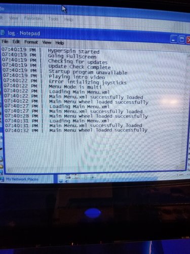

silverbullet Posted December 22, 2019 Posted December 22, 2019 Hi Guys New to the forum. Setting up my MAME cabinet and having some issues with Hyperspin. Hyperspin starts up fine and loads the emulator wheel just as it should. When I select an emulator it just reloads the emulator wheel again. Does not matter which emulator I choose. I have had this system working before, had it stored away for a couple of years because of a move. So I know it worked before, just wondering what could be causing this. Log file is attached. Any help is appreciated. Thanks
Spawk Posted December 22, 2019 Posted December 22, 2019 If I had to guess, I would assume you are using a filter (roms only) in HQ and have not set a rompath and extension.This is only needed when using a filter and note that you do NOT need to put executable path in there.Sent from my SM-A520W using Tapatalk
silverbullet Posted December 23, 2019 Author Posted December 23, 2019 23 hours ago, Spawk said: If I had to guess, I would assume you are using a filter (roms only) in HQ and have not set a rompath and extension. This is only needed when using a filter and note that you do NOT need to put executable path in there. Sent from my SM-A520W using Tapatalk Thanks for the advice. Tried that but didn't work. Tried the harddrive one different PC and worked fine. Not sure what is causing the issue but it is definitely PC related. It is an older PC and was off for a couple of years. When i powered it up it had a BIOS error due RTC battery being dead and audio card is not recognized. Not sure if this has an impact.
Spawk Posted December 23, 2019 Posted December 23, 2019 I thought it may have been resolved in latest version of HS but yes! You did need to have some sort of speakers plugged in!Sent from my SM-A520W using Tapatalk
