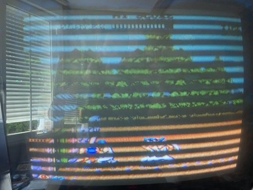

Only playing mame directly from the mame emulator shows the image good. (No small flickering like the arcade monitor frequency dropped and also the image quality itshelf.
is difficult to get a snap. But I will try to attach them.
Update:
I deleted the mame.ini and now launching from hyperspin this is what I see. Now it doesn’t flickers like the monitor frequency is too low but I see these horizontal lines

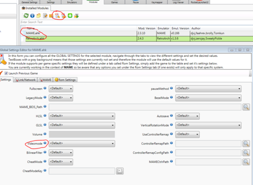

Ok, so despite whatever settings you've made in mame itself, you still need to tell RL what settings to use. You can do so by clicking the "edit global module settings" button here:
These are all "default" in the pic because I am using RetroArch on this system, not mame. Normally I would suggest setting "Videomode" to "ini" but did you say you deleted yours?
