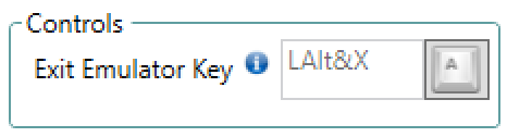

tancrede987 Posted August 29, 2020 Posted August 29, 2020 ESC is the Fusion364's key for swapping Windowed/full screen. On other systems (ex. MS-DOS), using ESC can also be problematic. If you're using RocketLauncher, change the default key (GLOBAL/Settings->Controls Here, it's mapped to Left Alt+x
