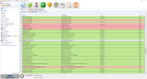

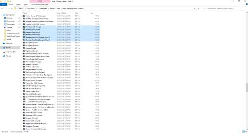

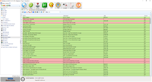

relic Posted September 26, 2020 Author Posted September 26, 2020 Hi i notice with some databases such as sega master system for example does not match with the no intro set anymore like it used to and hyperspin wont let me load any games but rocket launcher does ps is anyone else haveing this issue please let me know thanks regards les You Account Owner Friday at 08:19 AM 100%
alcoatjez Posted October 11, 2020 Posted October 11, 2020 There are 3 reasons for this: 1. No-Intro naming can change constantly: When new dumps are done: For example when a new dump from a Japanese cart matches an existing dump, the region can change from (USA, Europe) to (World) When there are mistakes in the naming which are corrected When a new version of a game is dumped, an older dump could be renamed since a version is added to the filename 2. There is a difference between No-Intro naming and HyperSpin naming. No-Intro naming can use these tags: [BIOS flag] Title (Region) (Languages) (Version) (D evstatus) (Additional) (Special) (License) [Status]. HyperSpin only uses Title (Region) 3. HyperSpin databases are not maintained anymore, see HyperList
