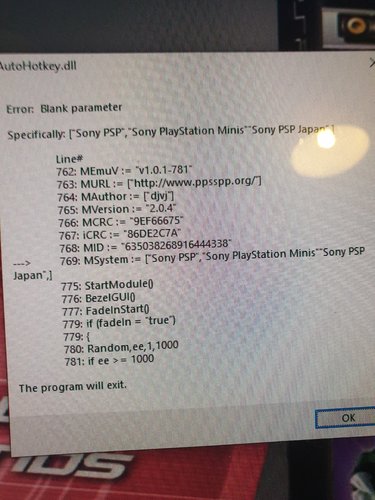

gigapig Posted October 8, 2020 Posted October 8, 2020 Those errors usually mean that Rocketlauncher is out of date.
rufferz Posted October 8, 2020 Author Posted October 8, 2020 On 10/8/2020 at 7:58 PM, gigapig said: Those errors usually mean that Rocketlauncher is out of date. Expand thanks for the information
gigapig Posted October 10, 2020 Posted October 10, 2020 Thank you. You're correct rufferz may get a better response at another forum but people can post wherever they please.
rufferz Posted October 10, 2020 Author Posted October 10, 2020 On 10/10/2020 at 5:06 AM, agent47 said: Usually, yes. In this case it's because OP tried to add "Sony PSP Japan" and forgot a comma between Minis and the Japan system.. That being said, anything regarding launching games should be posted on the RL forum. Expand so how do i fixes this . if you dont mind helping me out ..pls
gigapig Posted October 10, 2020 Posted October 10, 2020 On 10/10/2020 at 2:00 PM, rufferz said: so how do i fixes this . if you dont mind helping me out ..pls Expand Add a comma to whatever you edited by the sound of things.
rufferz Posted October 10, 2020 Author Posted October 10, 2020 On 10/10/2020 at 2:06 PM, gigapig said: Add a comma to whatever you edited by the sound of things. Expand i've not edited anything .. i've purchase a hyperspin arcade paid 3000 pound and the software is buggy as hell .hence why im in a hyperspin forum trying to get a fix for it
rufferz Posted October 10, 2020 Author Posted October 10, 2020 On 10/10/2020 at 3:05 PM, agent47 said: Yes, they can. But it's not just about getting a better response. If there's an actual bug in the module or a feature request it will go unnoticed here. Expand so is it because Rocketlauncher is out of date. or is it because OP tried to add "Sony PSP Japan" and forgot a comma between Minis and the Japan system.
rufferz Posted October 10, 2020 Author Posted October 10, 2020 On 10/10/2020 at 3:56 PM, agent47 said: It's because the seller (like all of them) had no idea what they were doing and what you bought is pile of junk. The system line in your module reads: MSystem := ["Sony PSP","Sony PlayStation Minis""Sony PSP Japan,] it should read: MSystem := ["Sony PSP","Sony PlayStation Minis","Sony PSP Japan"] You're better off starting from scratch and you won't get help from the RL forums on pre-configured setups as they're not supported. Expand thanks for the info but how do i edit that and fix it
rufferz Posted October 10, 2020 Author Posted October 10, 2020 i dont suppose you can tell me how to edit the module
gigapig Posted October 10, 2020 Posted October 10, 2020 On 10/10/2020 at 6:06 PM, rufferz said: i dont suppose you can tell me how to edit the module Expand Open the module in notepad++ look or search for that line of code, change it and save it. Failing that, contact the seller.
