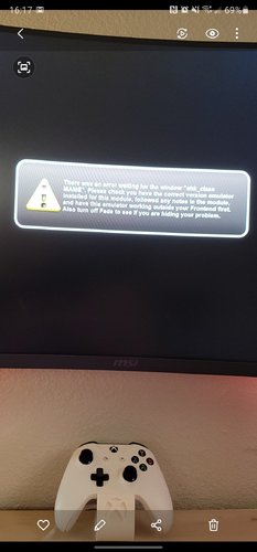

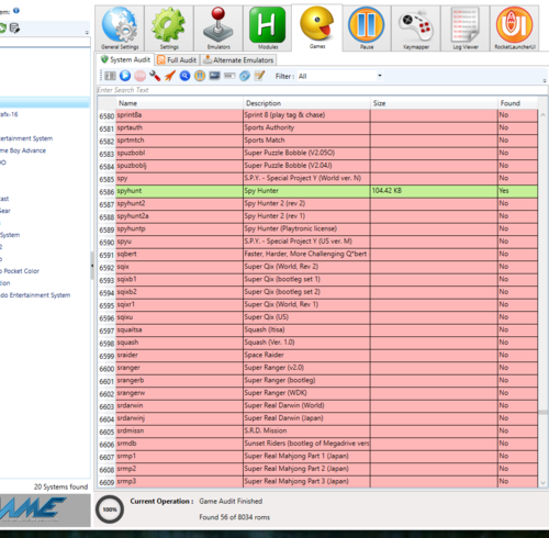

adavi125 Posted October 13, 2020 Posted October 13, 2020 I am new to hyperspin and still in the works of getting everything configured. My main concern at the moment is getting it to run with spy hunter. I have mame64 added and selected as the defualt emulator in rocketlauncher, no only will spy hunter not work but when I run the system audit in rocketlauncher there are very few out of the thousand or so roms I have added that it says will work. I would like to add that the audit says spy hunter works, but it fails to launch every time. Thanks in advance for any responses!
Spawk Posted October 14, 2020 Posted October 14, 2020 I am new to hyperspin and still in the works of getting everything configured. My main concern at the moment is getting it to run with spy hunter. I have mame64 added and selected as the defualt emulator in rocketlauncher, no only will spy hunter not work but when I run the system audit in rocketlauncher there are very few out of the thousand or so roms I have added that it says will work. I would like to add that the audit says spy hunter works, but it fails to launch every time. Thanks in advance for any responses!Ok a couple of things.1. The audit just looks at file names, has nothing to do with “working”. 2. The official mame module in RL has not been updated to work with the latest versions. You can find and download an updated one on the RL forums. This will fix the actual launching from HS.3. Just so you are aware, the names in the database (XML) might not match up exactly depending on what romset you have. You can edit the names in the XML with almost any editor (I suggest notepad plus plus).Sent from my iPhone using Tapatalk
